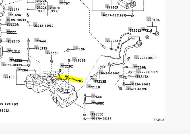

So, it turns out that it's the hose that comes off the breather line (#11) in that pic. Unfortunately, it's not in that pic. It goes from the filler line to a green barbed connector on top of the tank.
It's highlighted in yellow. No part number that I see.
https://parts.hiltonheadlexus.com/a/...2430-7701.html

I hate to say this, but the line you highlighted comes with the gas tank by the looks of it.
You can confirm with the dealer, but I'm pretty sure it's made in a way the it's assembled onto the tank during production and cannot be physically removed.
That's why there is no part number in the diagram, it's part of the tank.
Note in the pic below the red arrows. The line in question is molded onto the green unit, same with the line that goes between the two pink units.
And the green and pink units are bonded onto the tank...they can't be removed either.
