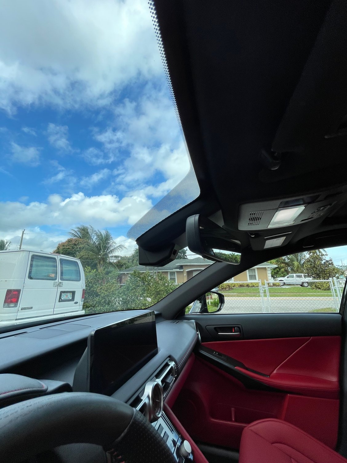

Originally Posted by Dc5nomore
@TipsyTonio can you provide some photos of your new dash-camera installed? I take it you went with the Front: 4K (2160P) 64GB?
Originally Posted by Compromise
Did you get the rear camera as well? I see that they have that option now too.
Yeha I only went with the front. When I ordered it only the front was available. Now I’m curious what the rear looks like, but I’m 99% sure it wouldn’t work for me anyways since I have the power rear sunshade and at least on the ES forums, they’ve been unsuccessful in getting the rear cam not to bump into the sunshade. So bear that in mind when ordering. I also ditched the stock “Sandisk” 64gb card that came with it. Given it’s Chinese origin I highly doubt it’s an authentic sandisk. So I ordered a high endurance 64gb sandisk card from bestbuy. The reason I didn’t go full 128 is that Fitcamx claims that using 128 would force you to do certain things on the computer instead of the app. Also, on the ES forums people complain about a flashing blue light at night. While the blue light is there, it is not in your face nor noticeable. I drive a lot at night and it hasn’t bothered me yet. Downloading from the app is the only thing that has been hit or miss. Even with airplane mode I still get failed downloads. But if it fails, I just try again and then it works fine. I’ve found that it tends to not fail if you let it load all the thumbnails before trying to download a video.
Update: I just checked the rear cam model. Bear in mind that if you get the rear camera, the front camera will be limited at 2K. So that’s some food for thought. Also, I think the rear camera does not look very OEM unlike the front one. But that’s subjective

This is very tempting... I've been wanting a dash cam but not a fan of having to run random wires in my car so this one would be great. How long have you had the unit? And absolutely no issues with the standard lexus safety features?

I installed the unit about 3 weeks ago. No issues besides the intermittent failure downloading videos, which is just the app being glitchy. And the Lexus safety system was my concern as well. But luckily I have had no issues. The systems that rely on the pre collision camera (lane keep assist, pre collision, and automatic high beam) all work normal for me.

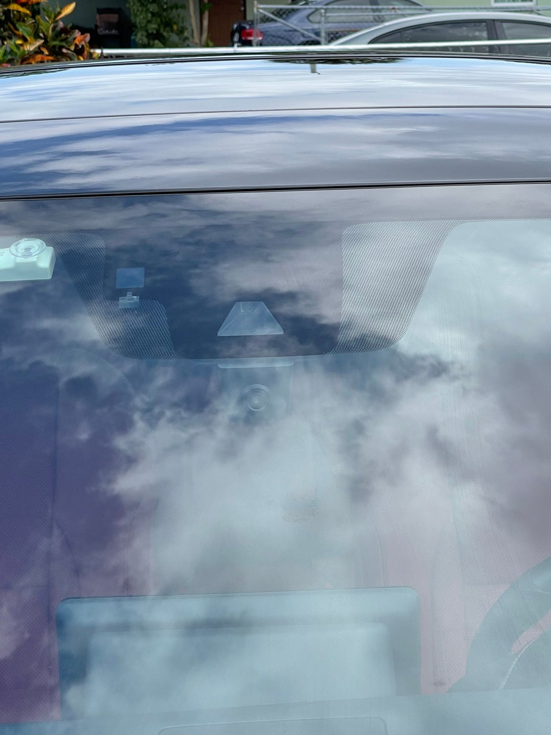

Just figured I'd come back and update everyone. I got the Fitcamx for a 2022 Lexus IS and truthfully it couldn't be any better. The installation was really simple and took probably 5-10 minutes. One thing to note, on other models you have to reinstall the factory top cover portion, but for some reason on the IS they include specific to the new housing. The housing in general is probably 1cm longer than the oem one, so it sticks out ever so slightly from the black marking on the windshield. Definitely not enough to be noticeable or an issue. The video quality is pretty good, though I will say I am skeptical of the whole 4k functionality, and that appears to have been disproved in other threads. Audio recording needs to be turned on in the app, but its definitely not top tier audio. Personally I don't mind it since my focus isn't to record audio, but rather video. Despite the 4k concern, I'd say the quality of the camera is great and it is also great in the night time. The only issue I experienced with it was with downloading videos on the app, but one suggestion I found on reddit, and later in the user manual as well, was to disable cellular data on your phone or go into airplane mode, and then connect to the camera. After doing that, downloading videos no longer failed.

I think that looks pretty slick but would probably interere with a mirror stem mounted radar detector. I almost returned my blackvue and ordered this and then realized it's right in front of the radar antenna. After installing the blend mount radar mount and mirror tap I can't go back to any other method haha. To the fuse box for me for the dash cam.
