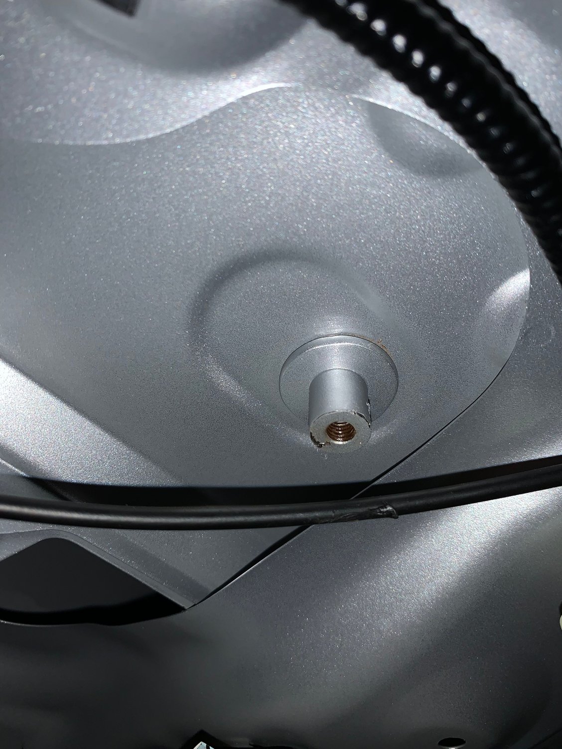

Here is the inside of the trunk, again, for clarity. You can see the two screw anchors.

I just went through this exact same headache...stainless steel, phillips head, license plate screws decided to corrode and seize. Stripped the phillips head so I cut a groove for a flat head screwdriver which also stripped. I then shaved down the round screw head flat on each side to clamp vice grips on it but also just stripped the screw head more. I was trying to avoid drilling and tapping but the screw head was so mangled at this point. I actually got a Dewalt combo drill bit and tap kit from home depot (https://www.homedepot.com/p/DEWALT-9...1420/204787310). I drilled from the inside as shown in your last photo and then tapped the threads from both inside and outside.
Just FYI, those insert, "top hot" looking, threaded pieces in your last photo are actually some sort of metal. They act as a good guide when drilling out the seized screw and the process was actually more simple than I thought.

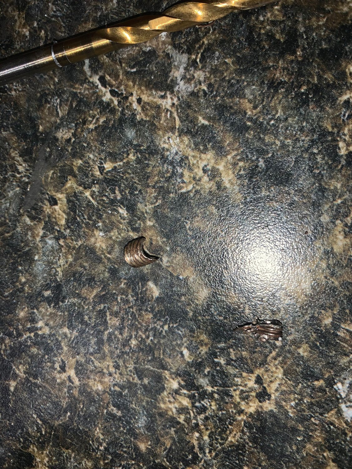

Just pulverized the screw from the backend using a 3/16 bit. There was so little left of the screw I had to use the other, good screw, screwed in from the backend to get the remnants out. Very poorly engineered, imho, if this is the only option. That anchor behind the trunk should be a less permanent fixture.
