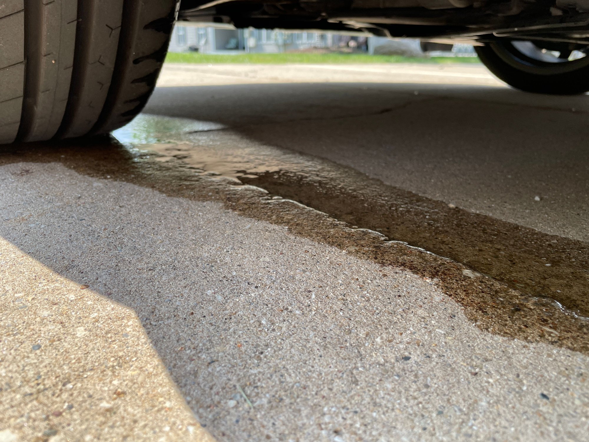

Has anyone experienced a catastrophic brake failure like this? I was driving along and as I approached a traffic light, I pressed the brake pedal and it went all the way to the floor. I was extremely lucky that the light turned green and the cars in front of me got out of the way in time. Otherwise I would have plowed through several others.
I was able to drive home slowly as I was only 0.1 mile away and pulled into the drive way. What I saw was shocking. There was brake fluid all over the wheel, tire and wheel well.

I couldn’t figure where it was leaking from. Pressing the pedal when I went back to check, it was making a loud noise and the pedal was vibrating too. So I didn’t want to mess with it. Have an appointment for Monday to get it checked out.

Ok update on the issue. They put it up on the lift and showed me the leak. It was leaking from the tip of the bleeder valve. The dealership claims they have never seen anything like it ever. They’re sending it to Lexus for diagnosis.
It’s being fixed with a new valve and complete bleed of the system.

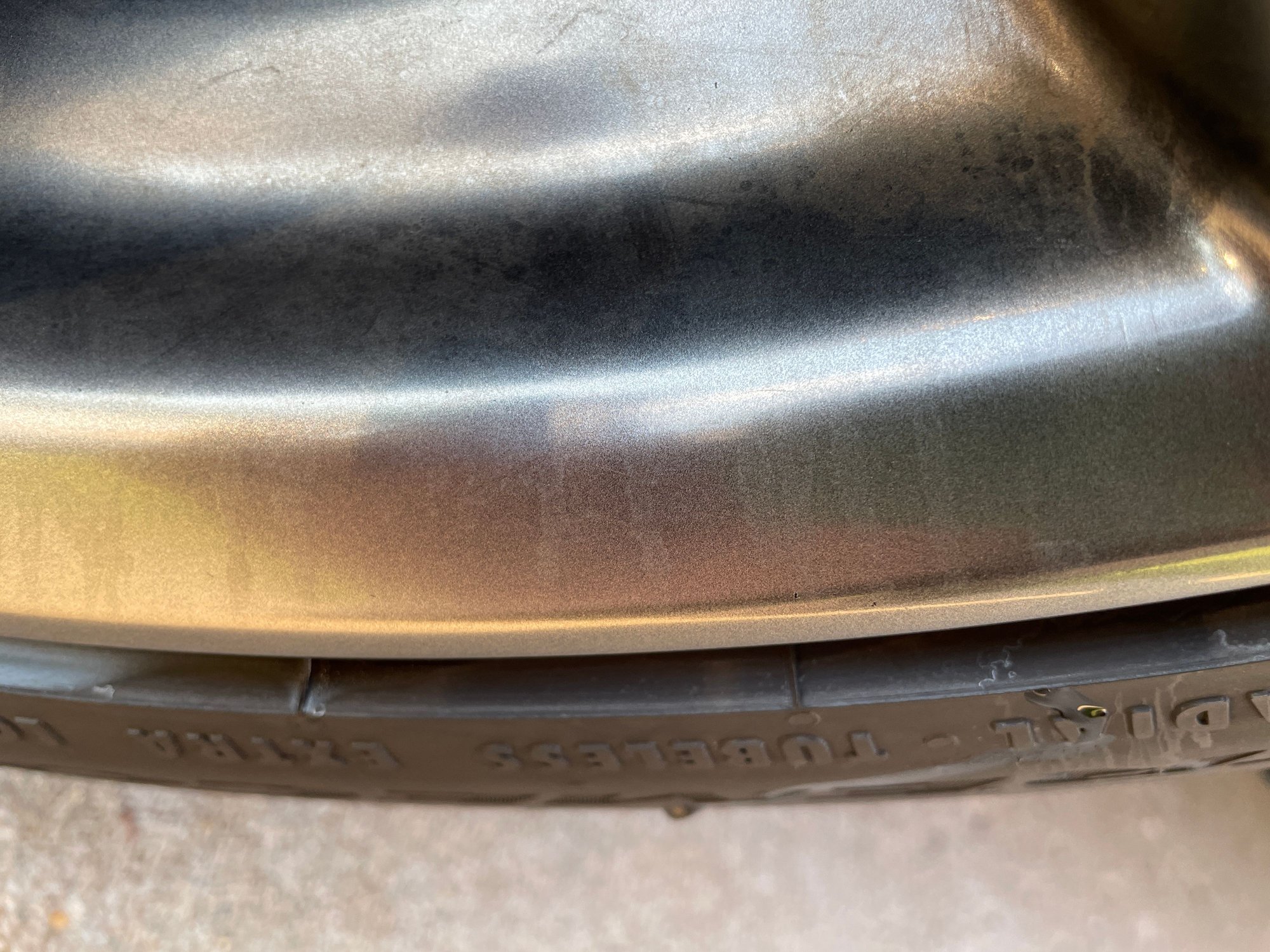

Just got the car back. Looks like there is some paint, wheel and tire damage. I tried all kinds of chemicals that I have to wash it off. Nothing is working.
