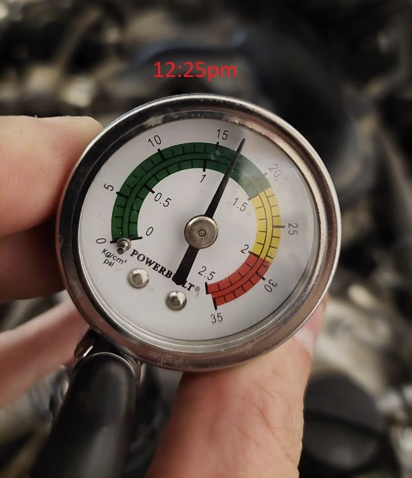

So I did the autozone tool loan program, cancelled amazon order.
Pumped to 17 PSI, after 10 minutes it was 16 PSI.
I did it again and after 20 minutes it still held 16 PSI... that's 1 PSI loss after 10/20 minutes, is that an issue?
I also relieved the pressure, then started the engine to see if there was a spike (dynamic test or something like that) and there was zero movement.
If this is normal then I suspect it has to be the radiator? maybe it's corroded inside despite the high flow? that is the last thing that has not been changed, new OEM radiator cap, new oem thermostat, new oem water pump... flushed the radiator, but who knows maybe that is it and it needs to be replaced like the other guy said
edit: left it on for 30 minutes, stayed at 16 PSI

I would consider the pressure test good.
The 1 PSI loss could simply be a larger hose, like the radiator hoses, expanding ever so slightly causing the pressure to drop a little...after the 1 PSI drop it stayed constant, which is really what you're looking for.
If it was the head gasket then the pressure would constantly drop until it either hit 0 or balanced with atmospheric pressure...which would be close to zero anyways.
Literally the only thing left is the rad despite it seemingly flushing ok.
