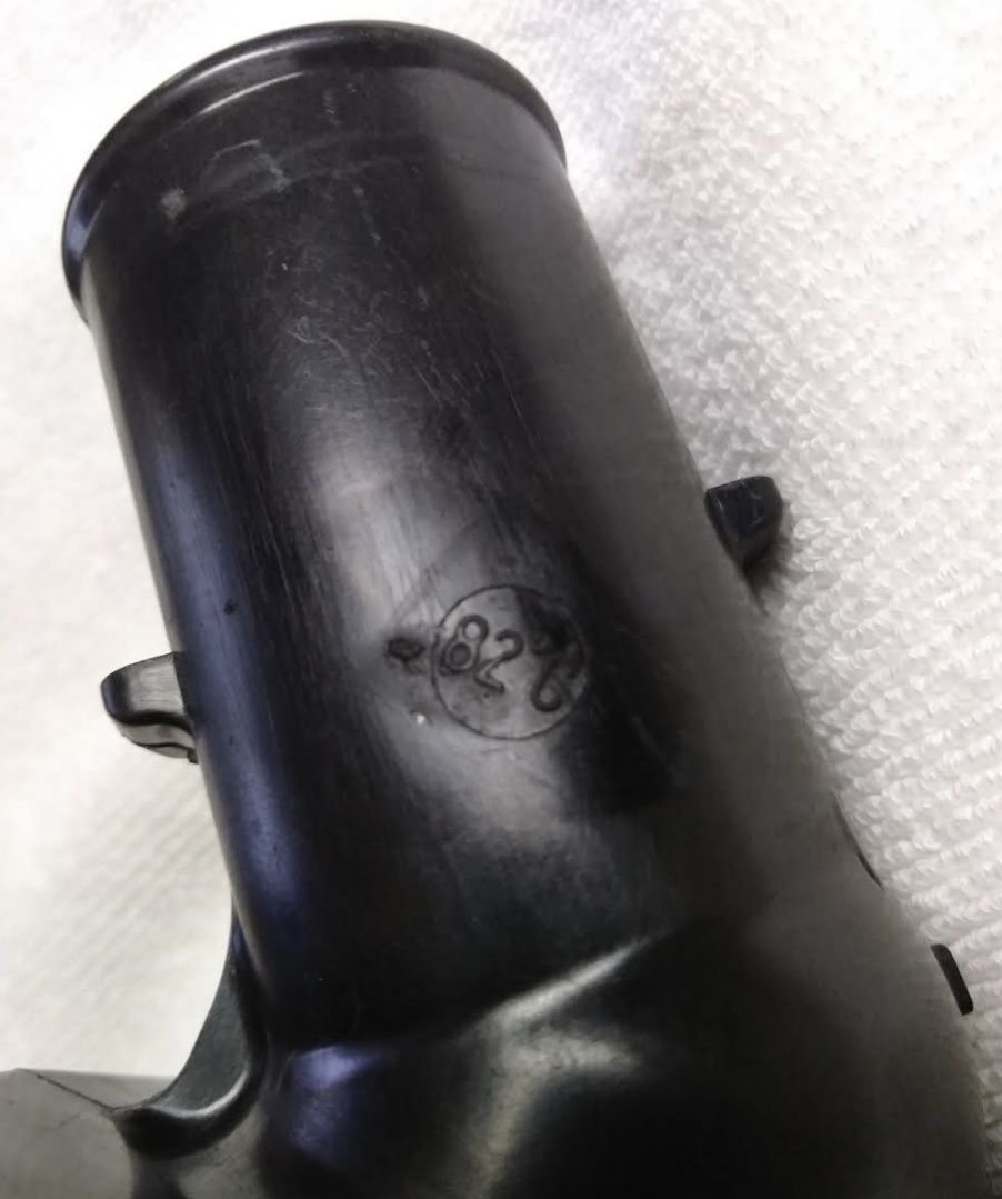

the side of the housing says 82C, the old googles says that is 179.6F, so 180. (this is the original one I pulled)

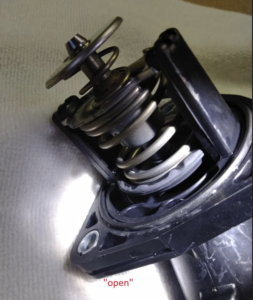

I put it in a pot of water to see how far it would open and at what temp
at 200 it was what looked to me to be barely open
this is at boiling temp, i took it out and immediately took a photo...from the photos online I have seen, that large spring should collapse much farther than that, the opening here doesn't seem large enough to allow efficient circulation which would explain why it would get 3/4 up the gauge then go back to normal running the heater on full blast, it was allowing SOME, just enough to not completely overheat. I'm reading that these duralast ones aren't opening until a little over 200. If Lexus designed them to open at 180, they did that for a reason.
I could see how the duralast one not opening until at least 200 would mimic these same symptoms, the thermostat opens when the coolant is already too hot per manufacturer spec, by the time it circulates to cool it gets a little below 200 and closes again...never getting down to the 180 lexus calls for before closing, thus not allowing the coolant to get cool enough. I'm not super knowledgeable here but that's how it makes sense in my mind. This thermostat looks partially open to me, what do you think?
EDIT: tried to shove a screwdriver in the opening when it was "open" to pry it open and see if it could open more, it did, then broke lol. I guess I could install this housing without a thermostat and see if it repeats the issue while waiting on the aisin one to come next week, not sure what a lack of a thermostat would do to emissions components or other things though, might get the "open loop" code

I think your assessment of the old and new thermostat are spot on.
If the new thermostat is opening later than intended then it will essentially cause the same issue.
I'm surprised the thermostat stamp was in Celsius...I just assumed it would be Fahrenheit...but I think I forget to account for where the car is built...not where it landed.

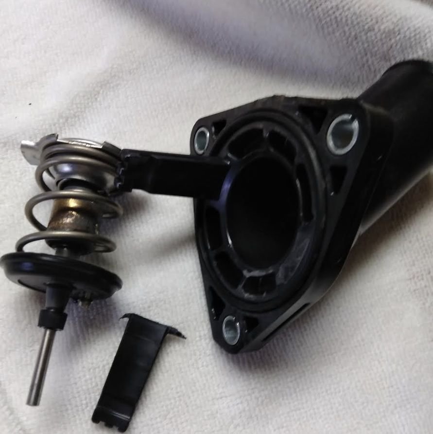

check this out, I pulled the duralast thermostat, it's actually made by "motorad" whoever that is. I threw it in the same pot, 180F nothing, 190F nothing, it didn't START to open until 200F and didn't open wider until boiling. I don't even know if it was fully open cause water only gets so hot. I installed the old housing with no thermostat and I'm going to see how that runs while I return this POS one to autozone
