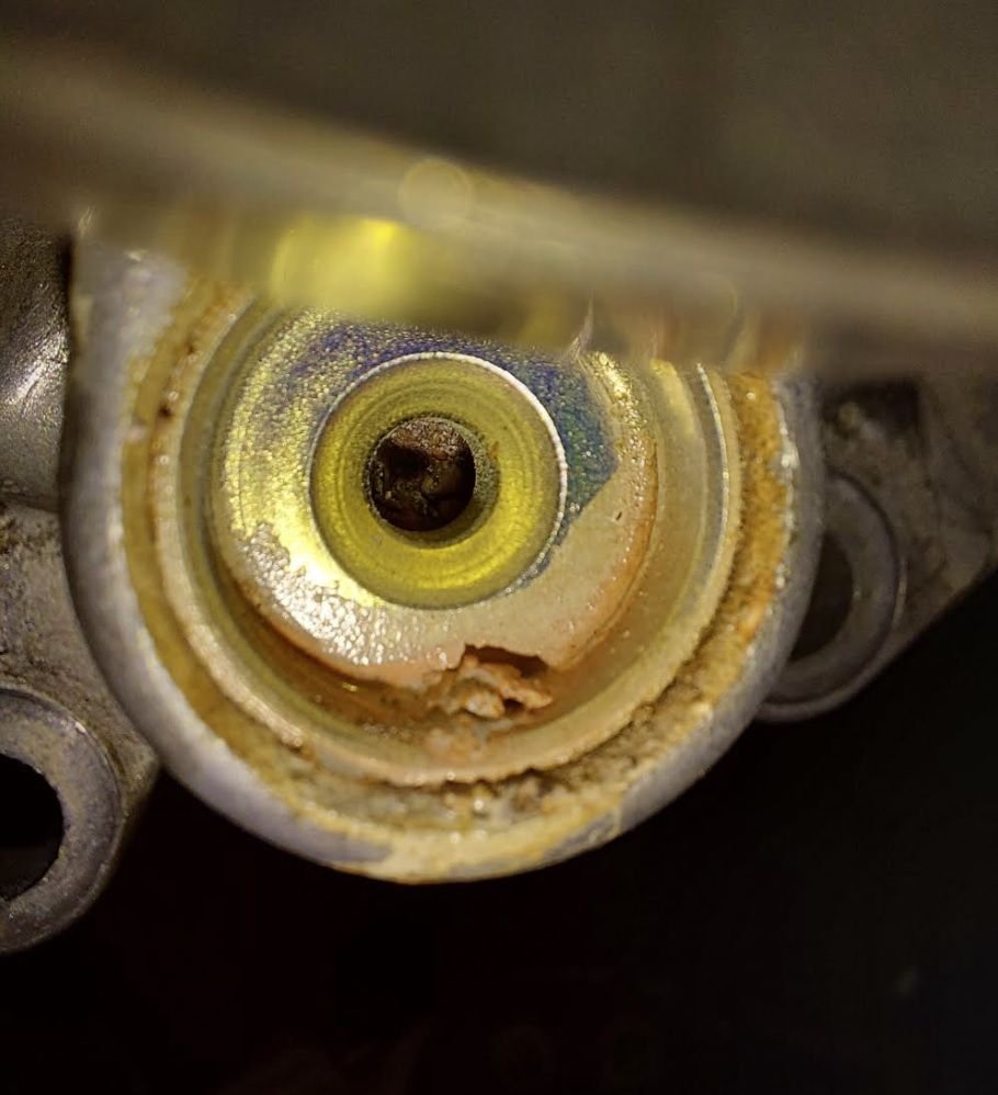

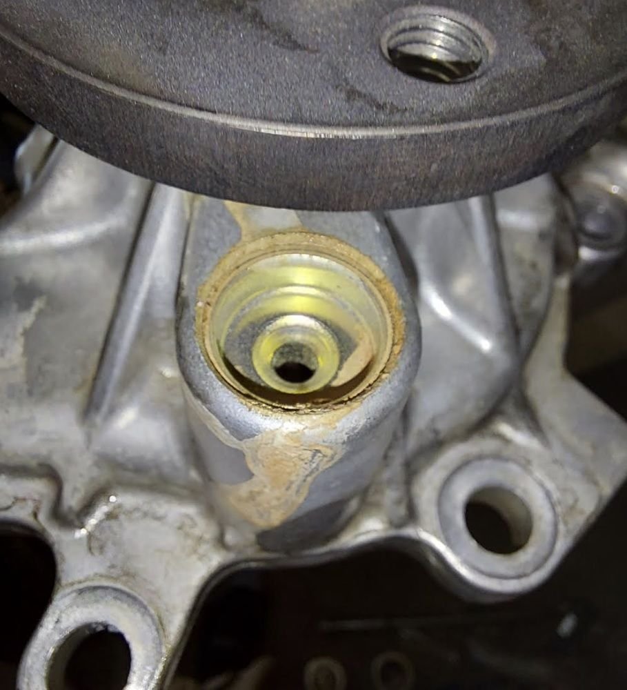

the inside of an original water pump with 192k
looks pretty damn clean, impeller seems fine.... i did see what COULD be some leaking, but it could have been from coolant that leaked down pulling the thermostat twice? I never saw any coolant on the ground under the car and the inside of the pulley just had dirt, no dried coolant so idk..
printed a picture of the water pump, taped it to cardboard and punched the bolts through as i took them off to keep track...thought it was a good idea

The inside of the waterpump is so clean you could eat off of it...I wouldn't recommend it though lol!
That's actually a legit good idea to print out the pic of the waterpump for bolt hole reference.
From the pic of the breather hole I would say the waterpump was weeping coolant slightly...which Toyota will say is normal to an extent.
Certainly the waterpump was on the road to needing replacement, but it would have held out a little longer...I would say no regrets replacing it now.
That amount of weepage wouldn't have caused an overheating issue though.

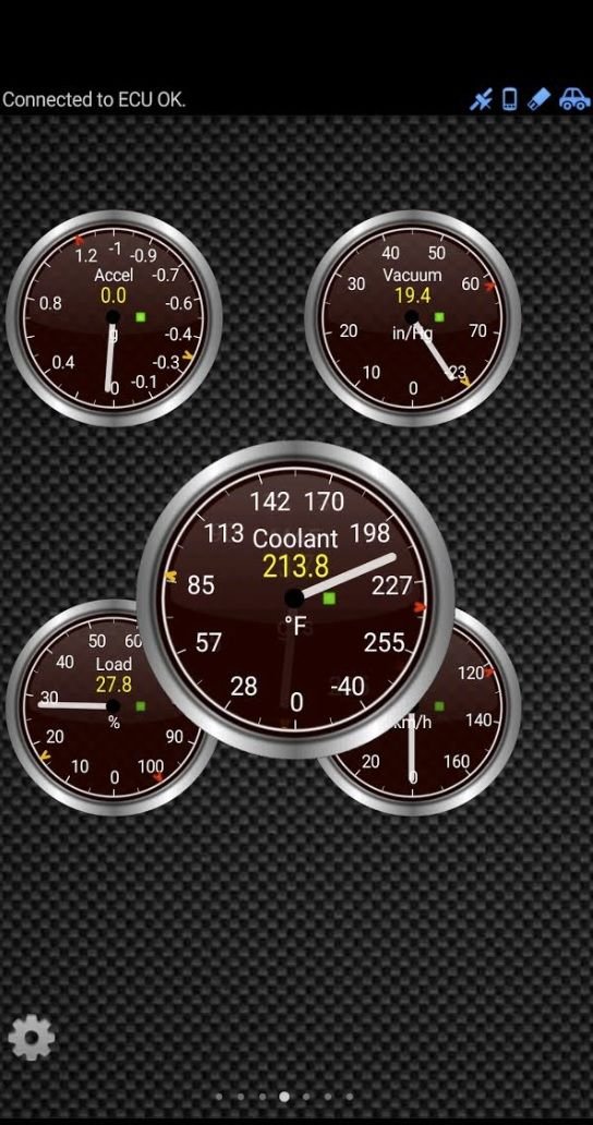

I'm lost seriously. I forgot I had an old OBD-II bluetooth scanner in, I downloaded the app and drove...if I get on it, temp got up to 237F... turn heater on full, dips back to a hair below half on gauge and says around 212F...I'm out of ideas. This means the temp sensor is working right?
If it was a head gasket I would be losing coolant, or getting chocolate milk in oil or coolant right? I have neither

For the 350 normal coolant temp reading is between 167-212F...factors affect this like altitude, ambient temp., blah blah blah.
From your own account with the scan tool the sensor seems to be working.
