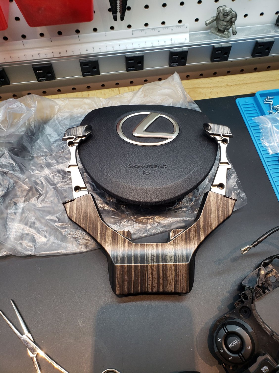

So this took a couple hours and the top two pieces that I have circled in the previous post were such a pain in the *** to wrap..smh
I can't tell if I like the left side plastic switches or if the wrapped right side switches is too much.... Opinions?

A bit too much for me. And holy crap, your work area is way too neat, you don’t have enough tools! I’ve got drawers and drawers piled full of tools, no way I could hang ‘em all up on display!

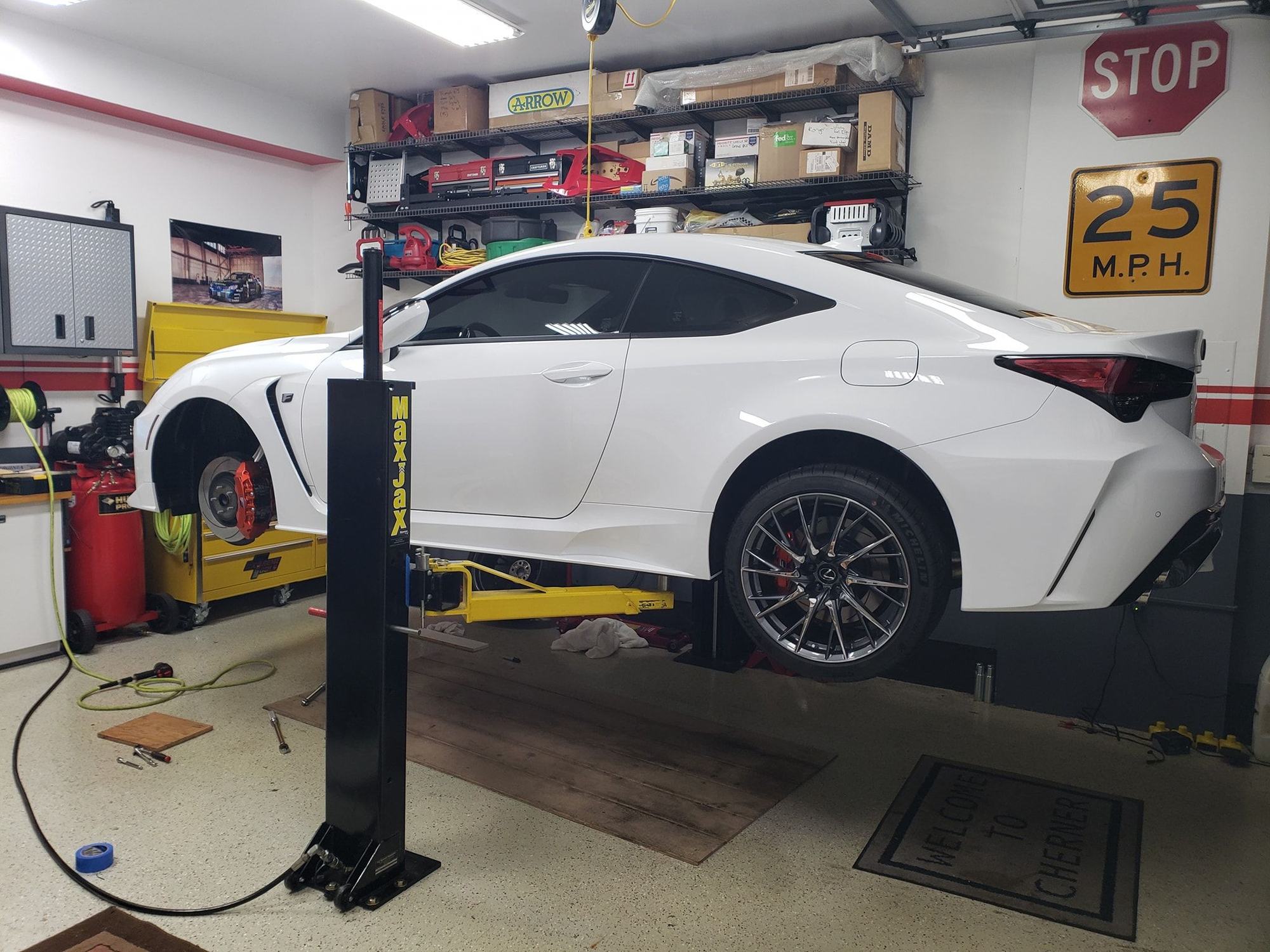

This is my modding room so more precise stuff is here, that's why it's clean. Actually the way it is now it's not clean at all. there's too much crap on the work benches. But I have like 3 projects going on now with leds and other various stuff..etc.. Soldering stations/3d printer..etc. The stuff on the peg board (I'll take pictures when I get home) is what I use most often. I have multiple cabinets below with tools and a tool chest in the closet that's out of sight, but the work bench is shaped like an L. Don't get me started on what I have in the garage, including a lift and tools..lol. Any time I can buy a new tool I do.
