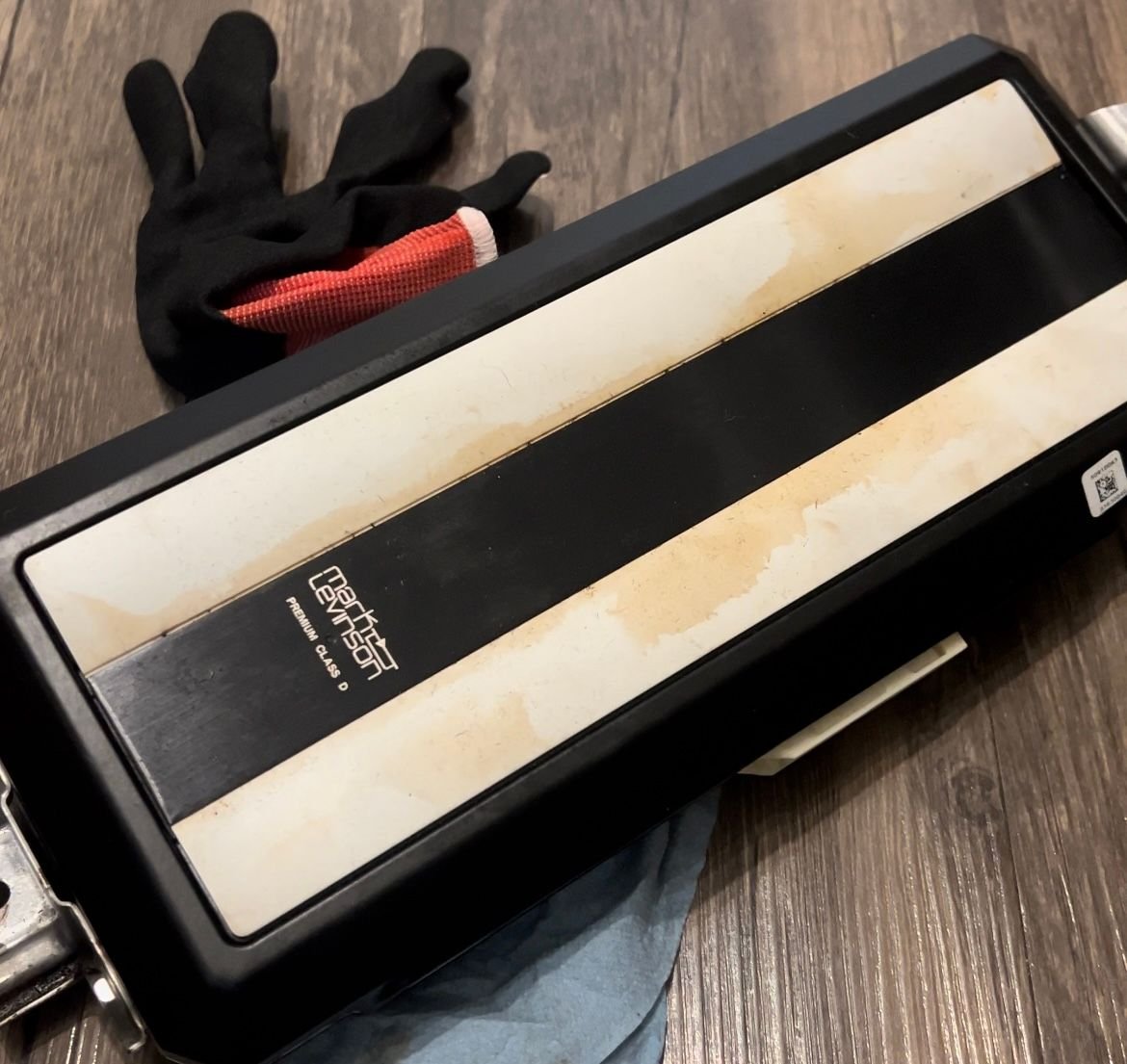

11/19/2024 - Update on ML Amplifier in My 2014 Lexus IS350 F Sport
Since writing my original post over four years ago, I’ve had no issues with the audio in my car—almost as if things were going too well. However, as with most things, this streak didn’t last forever. Over the past few months, I started experiencing intermittent problems with my audio cutting off randomly or becoming completely unresponsive. Running diagnostics revealed the now-infamous B15C3 code once again.
This time, I was determined to get to the root cause of the issue. To provide some context, I am the fourth owner of this vehicle and take extreme care to avoid having liquids in the trunk area. Despite my precautions, I suspected something deeper was at play.
Investigation
I decided to pull out the amplifier to see what was going on. Upon removing it, I noticed it was coated in a sticky, greasy residue that resembled aged Coca-Cola. Although I know that Sasnuke and others have warned about the vents near the amplifier potentially breaking and letting water in, this seemed more like someone had spilled something in the trunk at some point.
Further inspection revealed that the residue had seeped into the power connector, which I suspected was the source of the problem. However, none of the 30-amp fuses for the amplifier were blown, ruling out certain power-related issues.
Curious to dig deeper, I carefully opened the amplifier case to examine the circuit board. Sure enough, I found signs of residue intrusion and what appeared to be fried components. This confirmed that I would need to either replace the amplifier or get it repaired.

Reflecting on this experience, I believe this issue likely stems from a previous owner spilling something in the trunk. While I’m $700 poorer, I’m relieved to have the amplifier repaired and functioning properly. This car has otherwise been incredibly reliable during my ownership, and I hope this write-up helps others who might face similar issues.
Code Error
Code Error
Power Cable Connector with Residue
Removed Amplifier with residue on top
