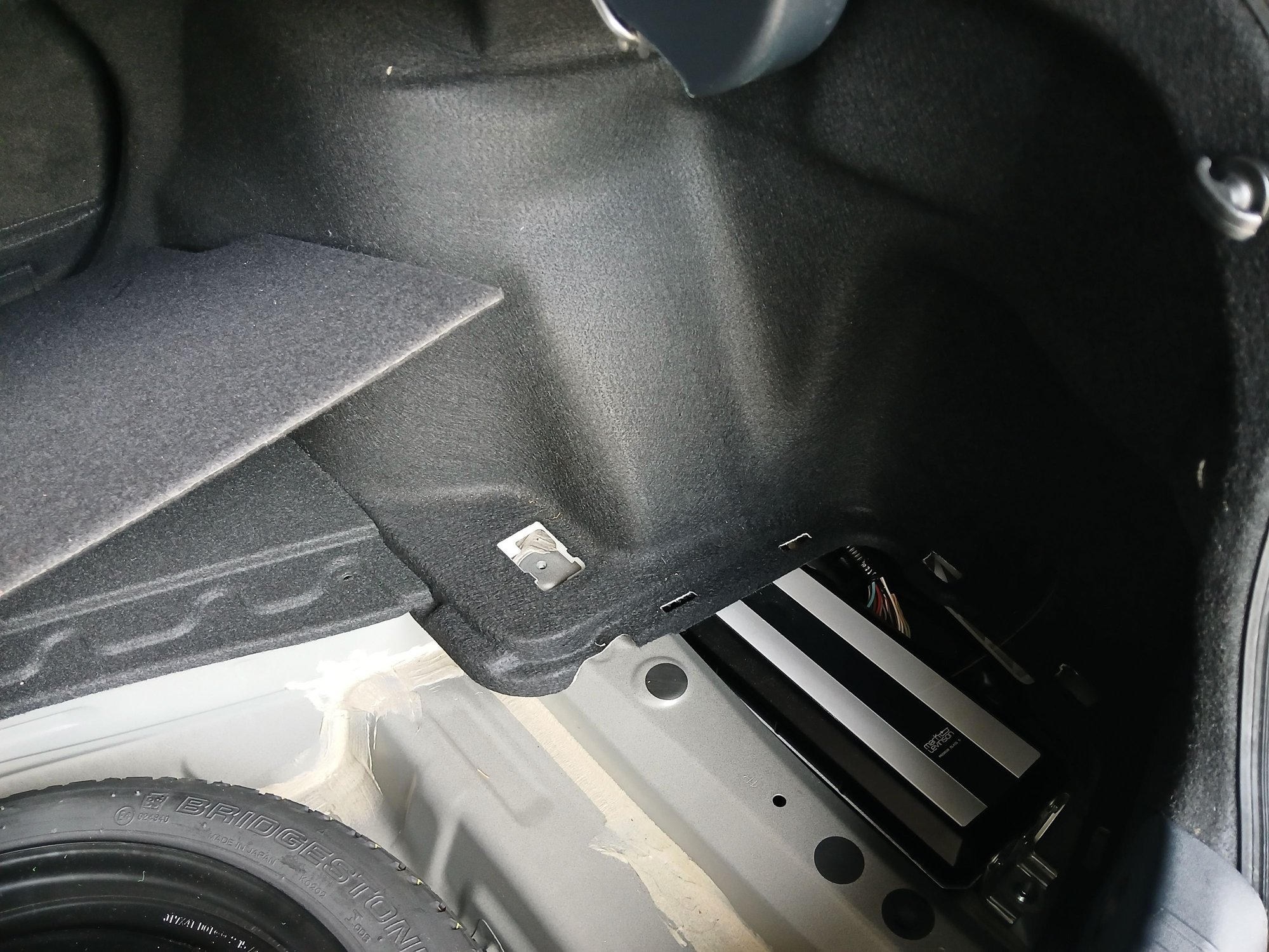

Hey @Sasnuke et al who may like to comment - this is wrt a 2015 is350 fSport - everything associated with the stock Mark Levinson system was fine, and before leaving for a few months, I disconnected the battery. After, getting back & re-connecting the batt, can y'all think of any reasons this might have impacted "water damage" or the amp getting blown? Everything still works fine EXCEPT for sound/volume, and also getting the amp error code: B15C3. Some Qs if you'd please:
  • Has anyone experienced success after trouble-shooting the amp for water damage &/or removing any corrosion, cleaning connections, etc?
  • Per the pix, I'm having a hell of a time removing all the trunk panels to access the amp - any suggestions?
  • I haven't accessed the amp as yet, but as you can see in the pix it looks pretty darn clean, do y'all think it's better bang for buck to just send it in for repair?

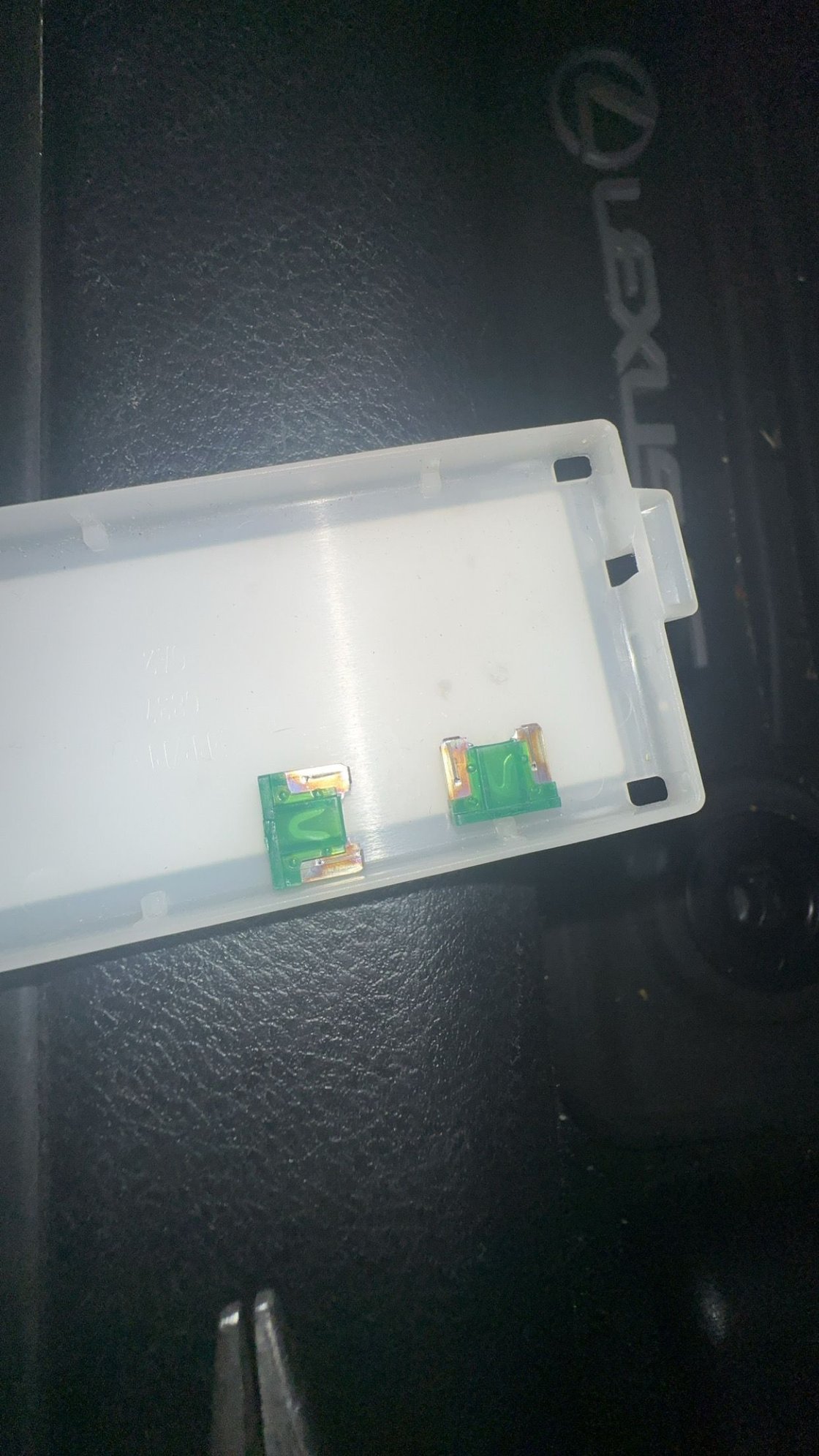

when you adjust your volume are you able to see your volume being changed? Dealing with the same issue of no audio, by my ability to change the volume and sound settings (bass, treble) is still intact. I have the same code as well but apparently it could mean the AMP is fine and there’s a short somewhere else. Checked my 2 amp fuses and there’s no sign of water damage around AMP.
does anyone have a diagram of all the wiring that runs through the car and where they are that are in relation to the sound system? I moved both my passenger and driver seat around a couple of days before this issue happened so I am wondering if a connection is loose or there’s a pinched wire somewhere. I looked under the seats and there didn’t seem to be anything loose.
30A amp Fuses look fine
No signs of rust or water damage.

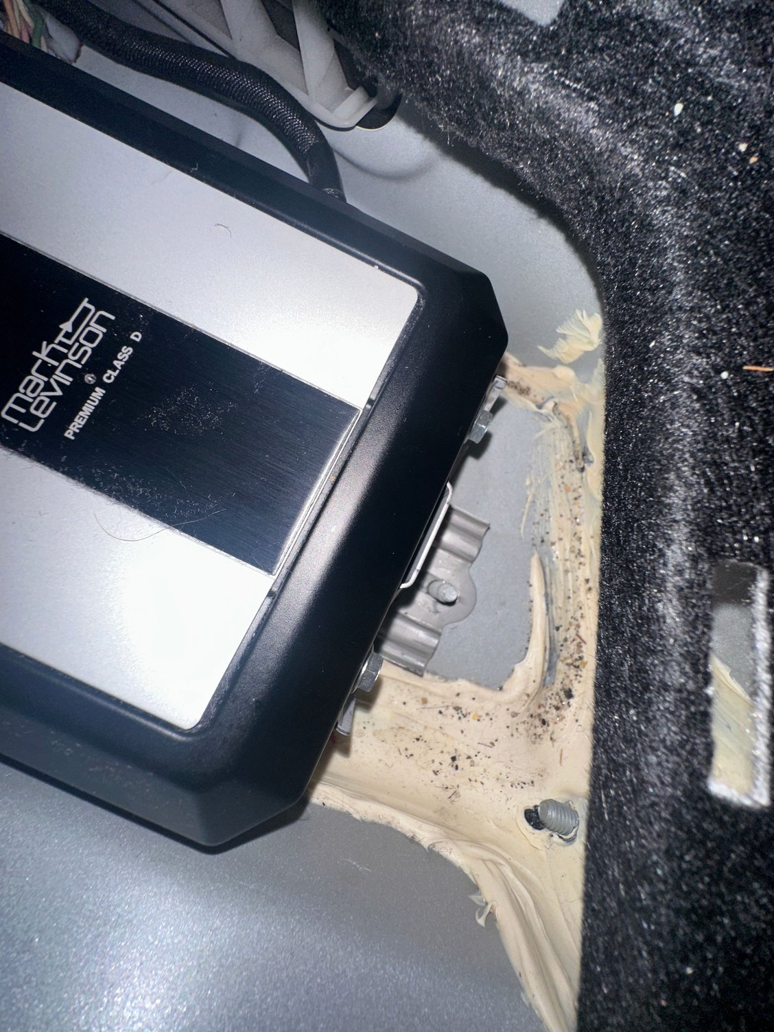

I just removed 3 or 4 of the carpet clips and moved the carpet as far as I could towards the middle as a could so I could access the bolts to remove the AMP.
