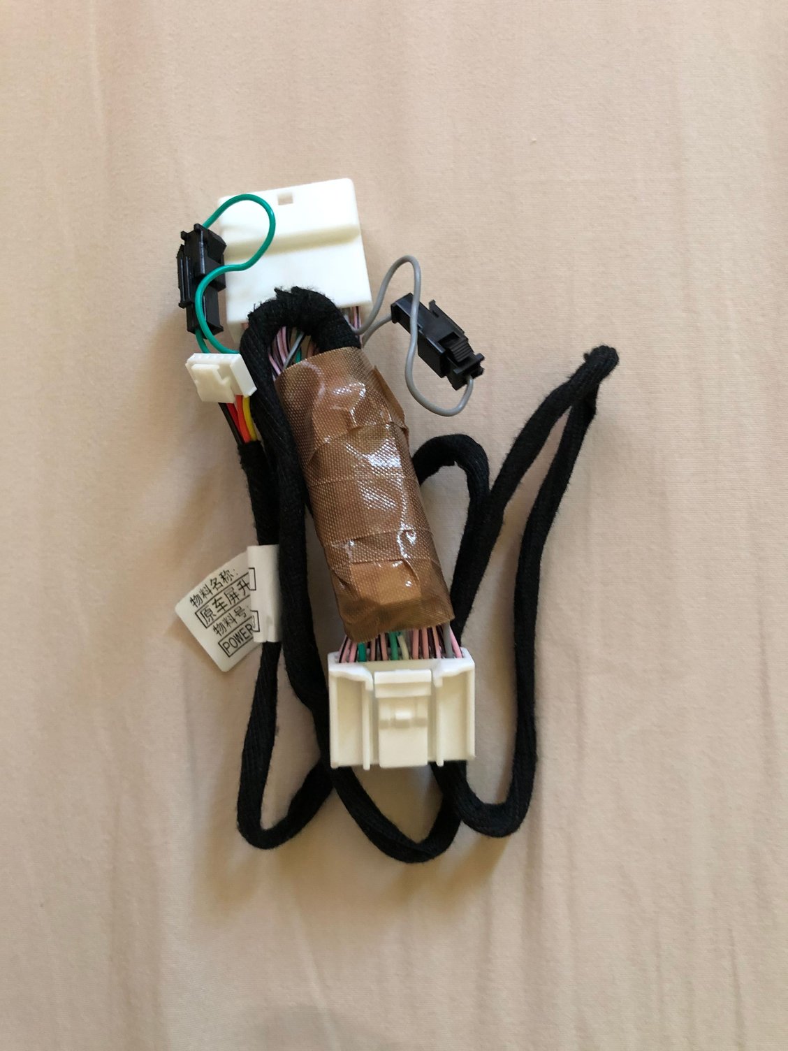

Does your joystick controlling Lexus menu in the background I was told this was normally? Does your harness come with this black connectors. I’d appreciate it if you provide some feedback because you have exact screen size and joystick as mine. I’m still trying to troubleshoot my unit, Carlinkit said they have a special cable just for my car but they want me to pay $30 for shipping I find this ridiculous since it’s their mistake.
It doesn't control the background Lexus menu when carplay is open. It only does when I switch to out of carplay. My car did come with the small black connectors and I had run the can control connector to the split screen display for it to work, even though we have the older style display.
You mean the same black connectors that was labeled “high new split display” and plugged it to “can control” connector right? DIP Switches are also 2345 ON the rest OFF?
You also didn’t have to hook up this display cable? I should’ve bought Road Top version from the beginning my stupid mistake. It looks like I have same CAN connection hooked up but it’s messing up my joystick.
Yes those black connectors labeled “high new split display” and plugged into “can control” connector. I also have the dip switches the same as you 2345 on and the rest off. The dip switches I set off of your picture you posted of the instructions. My instructions didn't have our screen size and joystick option for some reason. I messed around with different combinations and 2345 on and the rest off worked the best. It did come with that display cable you have pictured but I did not need to hook it up.
You also have “old car no split display” with loop back connector just like this?
Yup! I have them plugged in exactly like the picture you added even though we have the smaller display.
