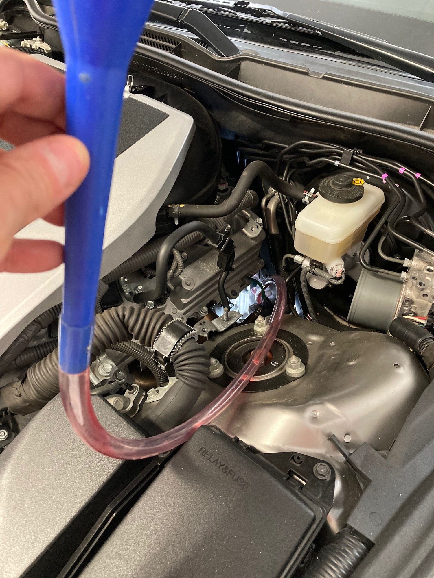

I have used the same process for the transmission as well. Just feed the hose in from the engine compartment and stay clear of the exhaust. Insert it only into the threaded hole, no further. With the tranny, it has to be running, so you dont want it to touch the internal parts. When adjusting the final fluid level, waiting for it to heat up to 106*F, I keep adding ATF until fluid starts to drain out the overflow hole. Then wait until the right temp Is reached and close the drain.

I was due to do a drain and fill on my transmission so I did it this morning and took some pictures. I did this stone cold this morning so the exhaust wasnt scorching hot. When I drained the old ATF 3.75 qts came out and I put a little less than 4qts back in. Started the engine and let it idle until it reached 95*F and then opened the overflow bolt. At 108*F on my Engine Link app I closed the the overflow bolt. You can see the coolant warming faster than the ATF.. this is so much easier than pumping it in from under the car. The hex socket is 5mm, the drain is 14mm and the refill is 24mm.
Note: the 1/2” ID hose should only be pushed in just as deep as the threaded hole, no further.
There are several apps you can get. I have an iphone. I bought enginelink hd $9.00 in the app store and the bluetooth device on ebay called LeLink $35. You need to put in a custom PID for the trans temp.
