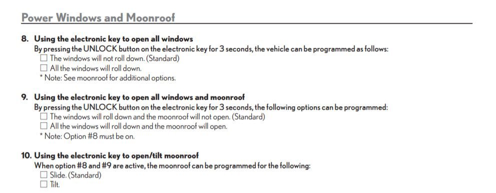

Here is a link to a thread with a pdf listing programmable features.
https://www.clublexus.com/forums/is-...-settings.html
Windows are set with moonroof, but moonroof can be programmed on it's own. And only thing listed for closing is when using mechanical key.

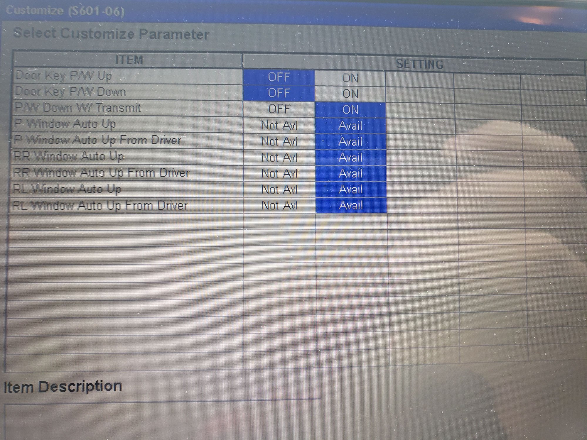

Take it to the dealership they can code it for you for no cost. See the screenshot below for you moonroof and window question. I had it coded on mines to open all windows and sunroof.

Here are some screen shots from the techstream as to what you can customize for the Power Windows and Moonroof:
The second option is for the roof operation with the remote...Tilt or Slide
The third option turns the remote option on or off for winding down the windows with the remote.
