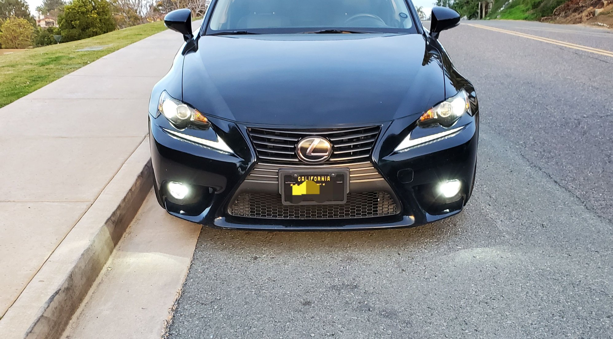

Low beam vs Fog light competition
Fogs off.....
Fogs on....
The oem projector above still had the vinyl tint on it.
