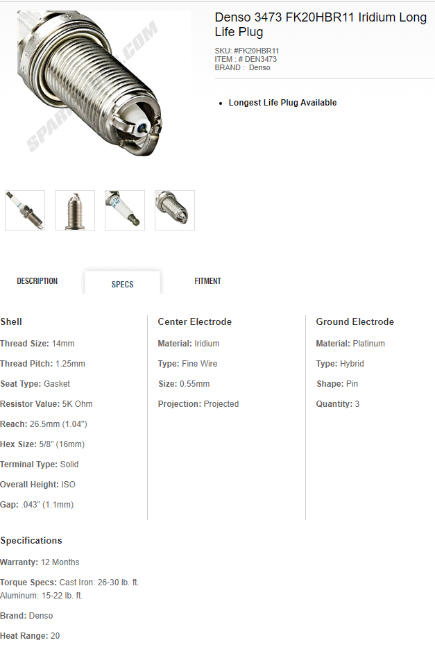

NGK website confirms they do fit an IS250. First glaring difference between the NGK and Denso is that the Denso has 3 ground electrodes at the tip, and the NGK has one.
The second glaring difference is the heat range.
Back in the day when Toyota first introduced double ground electrode plugs, around the mid-90's, if you installed a single ground electrode plug instead, you would get misfire codes.

What model Toyota uses the same Denso spark plugs as my 2014 IS250 f sport?
Old Oct 29, 2019 | 04:50 AM
Sasnuke's Avatar
Sasnuke
Joined: Feb 2017
Posts: 6,260
Likes: 1,752
The Denso plug FK20HBR11, when you go to the Denso site, shows that it only fits Lexus...basically any vehicles that use a variant of the GR-FE engine. They only show fitment up to 2017 though, so likely they haven't update for 2018+ yet.
So to answer your question, it looks like none.
My 2014 Highlander that I mentioned above uses the Denso FK20HR11...you will note it's almost the same number, but the "B" is missing, which makes it a completely different plug as it only has 1 ground electrode now, instead of 3.
