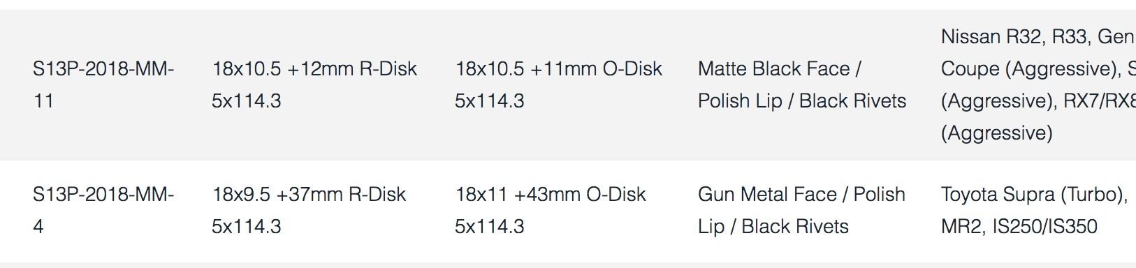

Just a dumb question about wheels, will this fit the 2017 Lexus IS 350F AWD? I have no idea about the whole offset thing and still don't understand it.

The first one will definitely not fit.
The second might fit with the right size tires and depending if you lower the car or not.
I don't think anyone has put 11 inch wide rims on the rear yet, so it's going to be trial and error at this point.

My car is on stock suspension and will the second one hit on the fenders? If not this might be the one I buy for the car. Thanks.

As no one has tried 11's on the rear, as far as I know, it's hard to give a definitive answer.
For the front, 18x9.5, you'd need a 255/35/18 tire, and the rear 18x11 would need a 275/35/18 tire...this will keep the front to rear circumferences relatively the same.
If you keep the vehicle at stock height, you will probably be ok. If you do decide to lower it though, you might have an issue depending on how low you go.
I think it will work, but you won't know til you try.
For the front my only concern would be if the tire is going to touch the suspension, not the fender.
The rear would be the opposite, that it would touch the fender before the suspension.

Alright, thanks for the help, I will contact the seller to double check about the fitment.
