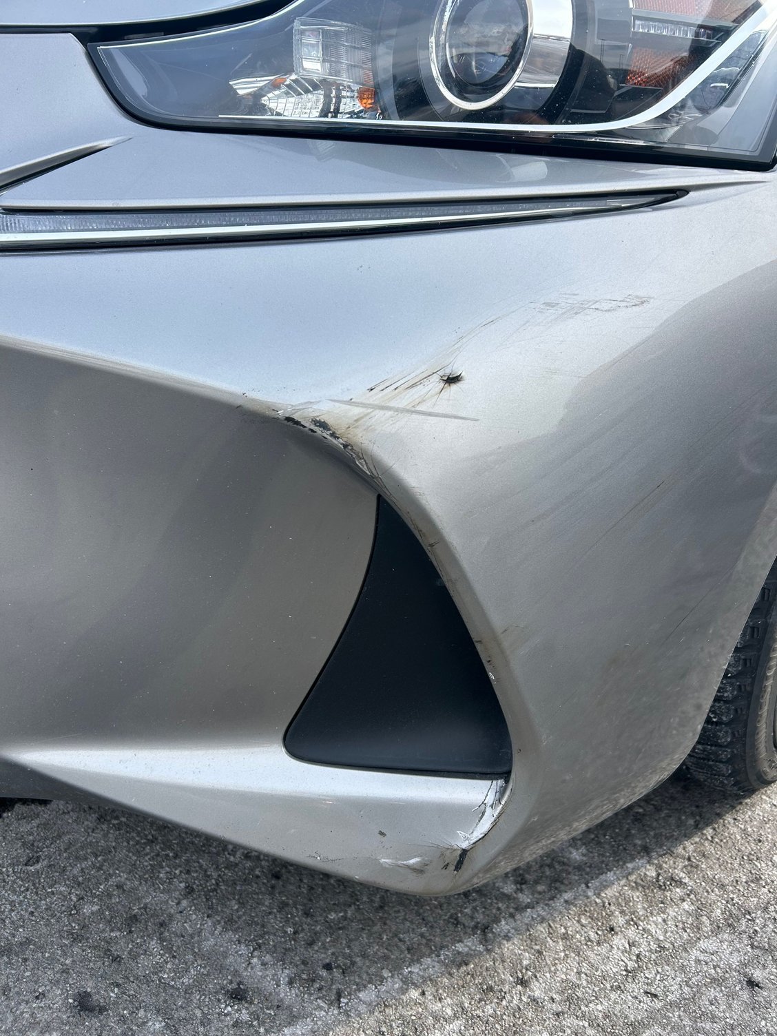

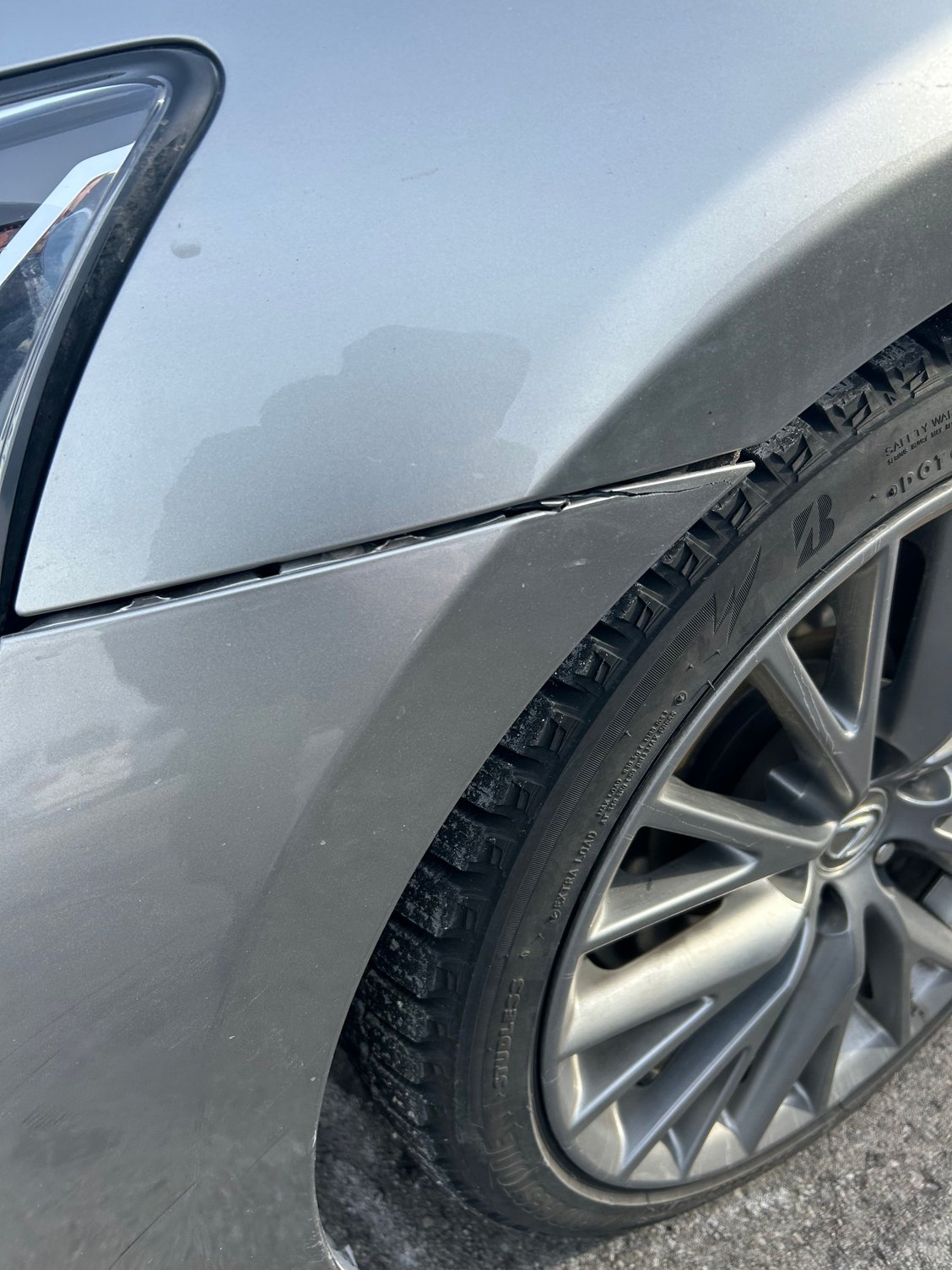

Old Feb 15, 2025 | 04:58 AM
IS300AWDSA's Avatar
IS300AWDSA
2nd gear
Joined: Apr 2023
Posts: 2
From: Ontario
Default Hit and run
Could anyone advise on whether my bumper is fixable or I need a whole new bumper? Someone backed into my car in a parking lot.
my only worry is the cracks you see in one of the photos.
