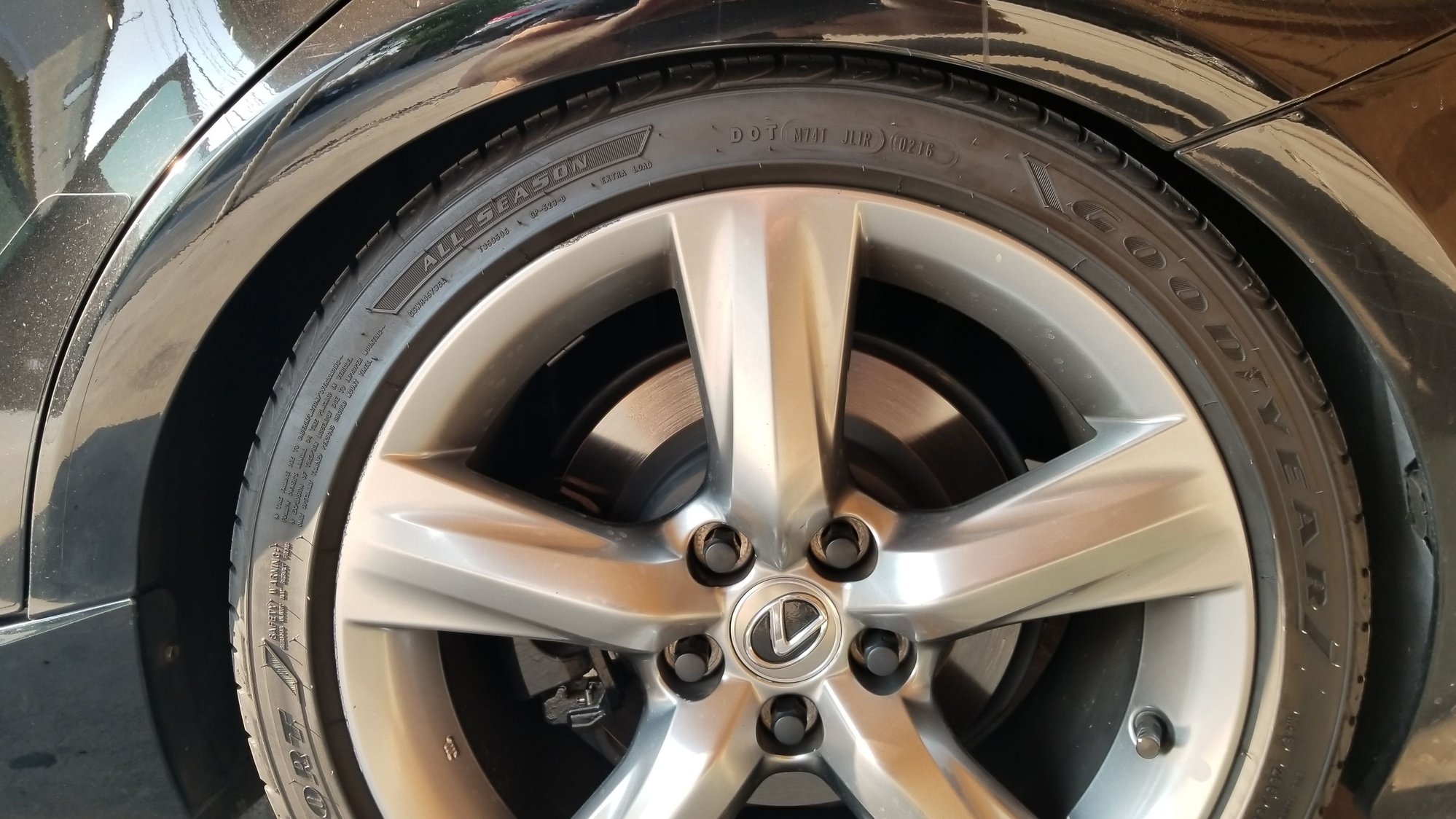

Noticed today my car is about 1/2 inch lower on the driver side rear than the passenger side.
RSR Downs, stock wheels, no chamber kit.
Springs were installed just last month... had about 12k miles on them I think.
Noticed it was maybe 1/4" lower right after install buy wasn't concerned. After all, there is more weight in the driver side of the vehicle.
Can anyone confirm this is normal? Have the same thing after putting some miles on your RSR downs?

Here are photos of the different heights. It looks more significant in person, about a 1/2" difference. Driver side being lower than passenger side.
