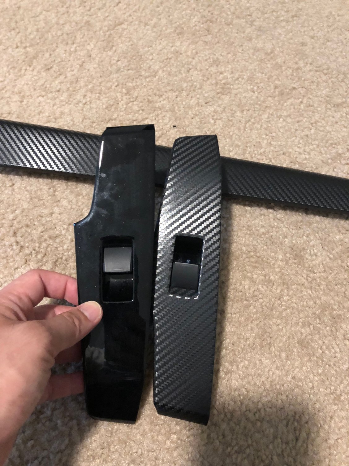

Default Me too
Did mine today. Took an hour or so.

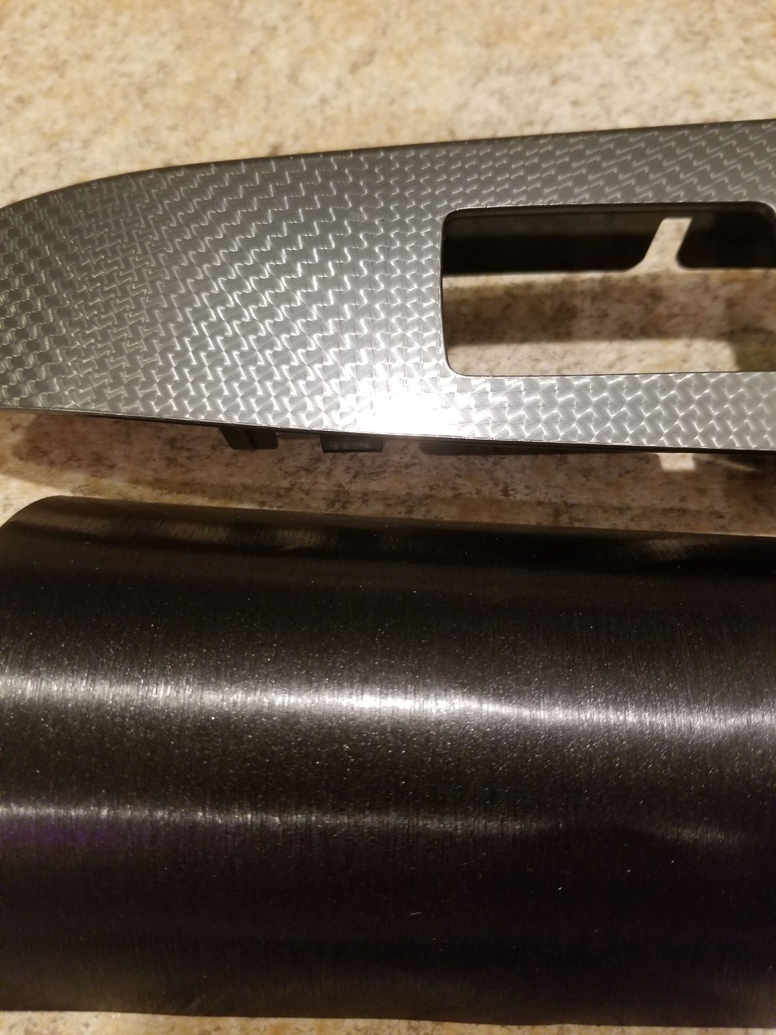

Originally Posted by HOMER350
Looking good. Is that 3M brushed black metallic?
Planning on using that on the remaining silver trim pieces bordering center console and door trims.
If I could get a good picture of that maybe in the light that be awesome!
Yep. Depending on which way you want the brush pattern to run, make sure to order wider than 12". Everything I had found online, including Amazon, sold 12" by X" length, with the 12" side being parallel to the brushing. Not good if you want the brushing to run longways. The eBay link below sells larger cuts. This vinyl was way less forgiving than the CF, very delicate to peeling portions up to flatten/remove bubbles/wrinkles. Not really able to stretch much without distorting the brush pattern.
Here are some pictures of a scrap piece that is a little dinged up. Let me know if you want to see anything else. When in the car, it looks a lot less shiny, not sparkly, and virtually black, even on a sunny day.

Got a much better idea based on those pictures description thank you.
Sounds just as if hoped, not too much pattern revealed.
I may be buying some more CF too as mine has already bubbled up where I stretched the vinyl near the armrest compartment...
