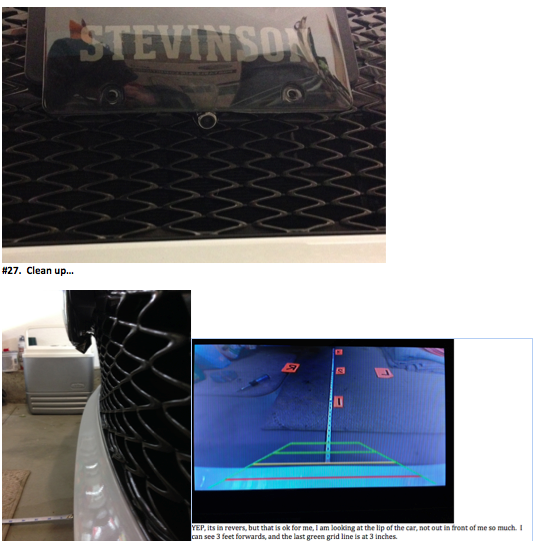

I searched the threads and could not find anything about a front camera install, so I struck out on my own and had pretty good results.
2014 Lexus IS 350 F-Sport - had it a couple weeks only driven it a few times - second car/toy + Colorado Snow - decided I did not want to be hitting curbs/parking barriers. My goal was to see the front lip of the car and not hit things, not see in front of me.
~$35 and 3 hours.
Camera is underneath and behind the front license plate holder (have to have a front plate in CO). The screen is in the glove compartment - connected to the door, so when you open it rotates out, and when you close it rotates back in - removed the shelf in there and installed a spring switch so when you open it the cam and screen power on and when you close it they turn off... Did not want to tear into the car trying to connect to the dash/nav screen.
Attaching a few pictures below.
Next project may be installing aftermarket parking sensors on the front - anyone else notice the two cut outs that are there just for this purpose? 1 on each side of the black grill.

more pics - have more of the whole install

Here is the DIY, hope this helps if others want to do something similar. Could not upload a .pdf or a .doc to save my life, so snapped screen shots... lets see how this turns out.

DIY - Front camera install No.2
