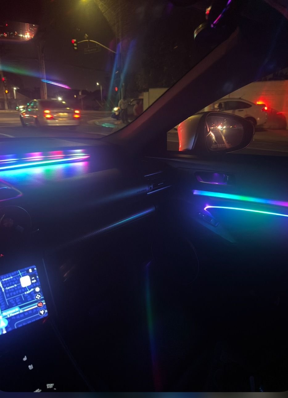

Easier to grab power from further down the switch… my car has ambient lighting but I tapped into the 12v for headlights and ground (headlights on = additional ambient on bc if I tapped into the ambient itself I got an issue of the power cutting in half going from P to D) but for me it’s not like Im gonna be able to see my ambient during the daylight anyways
