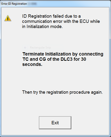

Question TPMS ID Registration Initialization Error
My 14 IS250, was giving an TPMS warning light error, i connected with Techstream and saw that sensor 1 was faulty and decided to replace it, due to the age of the sensors i decided to replace all 4 sensors at once before the other 3 start to give problems. i bought Denso 550-0105 TPMS sensors, looking online i saw how to register the ID on techstream going to the ID registration on utility in the TPMS section, and that's were the problems began. After i enter the ID's ,which i also notice that it does not give a timer countdown i get an initialization error. I tried connecting the TC and CG for 30 secs and still the same issue.
I am using Techstream V.12
Has anyone had this issue before? is there a way to take it out of initialization?
Thanks

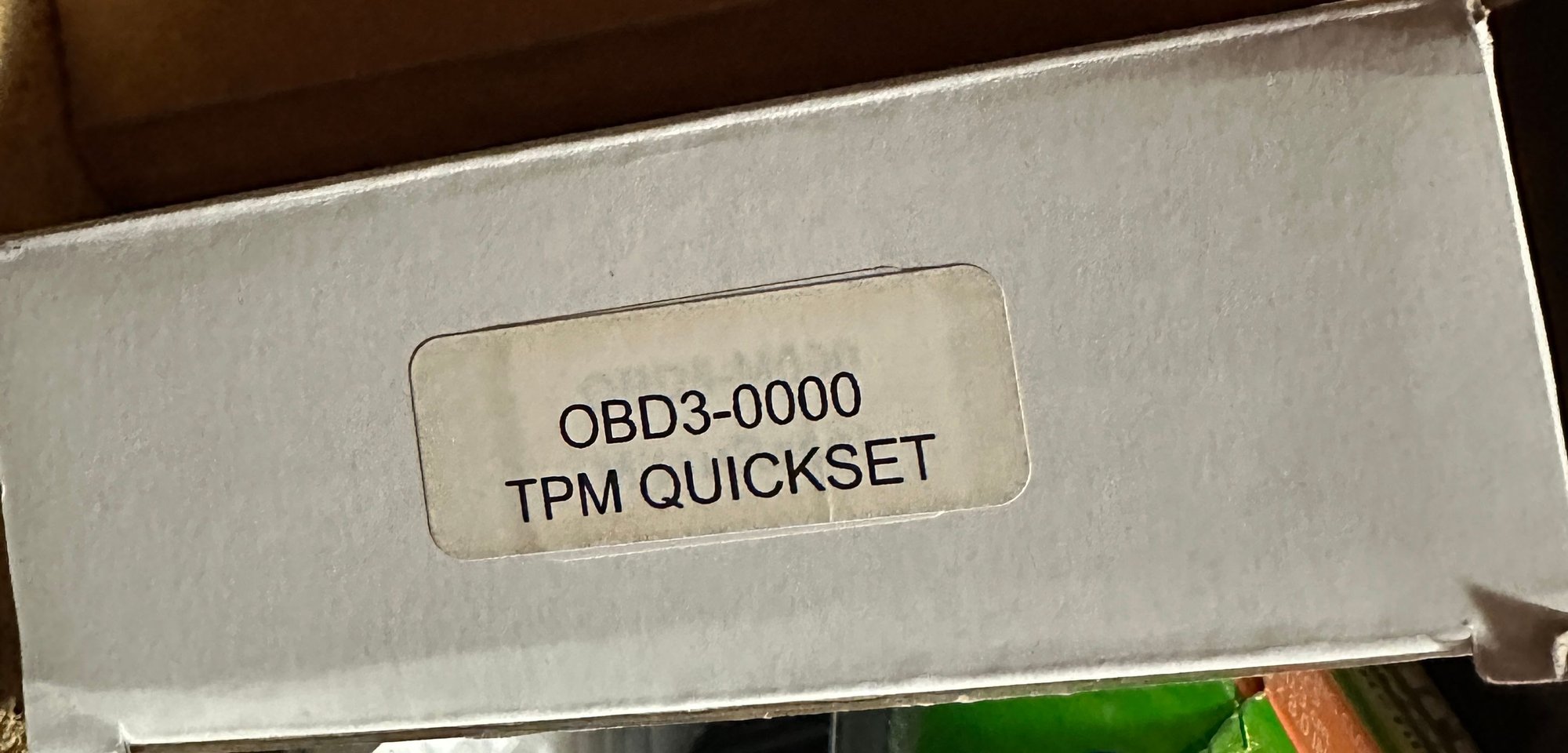

Have had no problem loading the TPMS values with my ATEQ Quickset. Use it twice a year, to flip between summer and winter tires/wheels.
