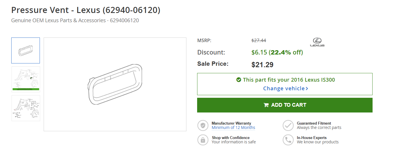

If you can smell exhaust entering the passenger compartment it might be entering through a damaged or broken cabin vent located behind the rear bumper cover. The cabin vents have rubber flaps that should close to prevent exhaust from entering the car. This can be more noticeable during hard acceleration while a front window is open.

I didn’t know that was even a thing!
Would you know happen to know where I can order the part from?
Google search wasn’t very helpful
Thank you

There are several Lexus dealers that sell parts online, you'll have to choose one.
The part is difficult to find in the catalog, part number shown below.
