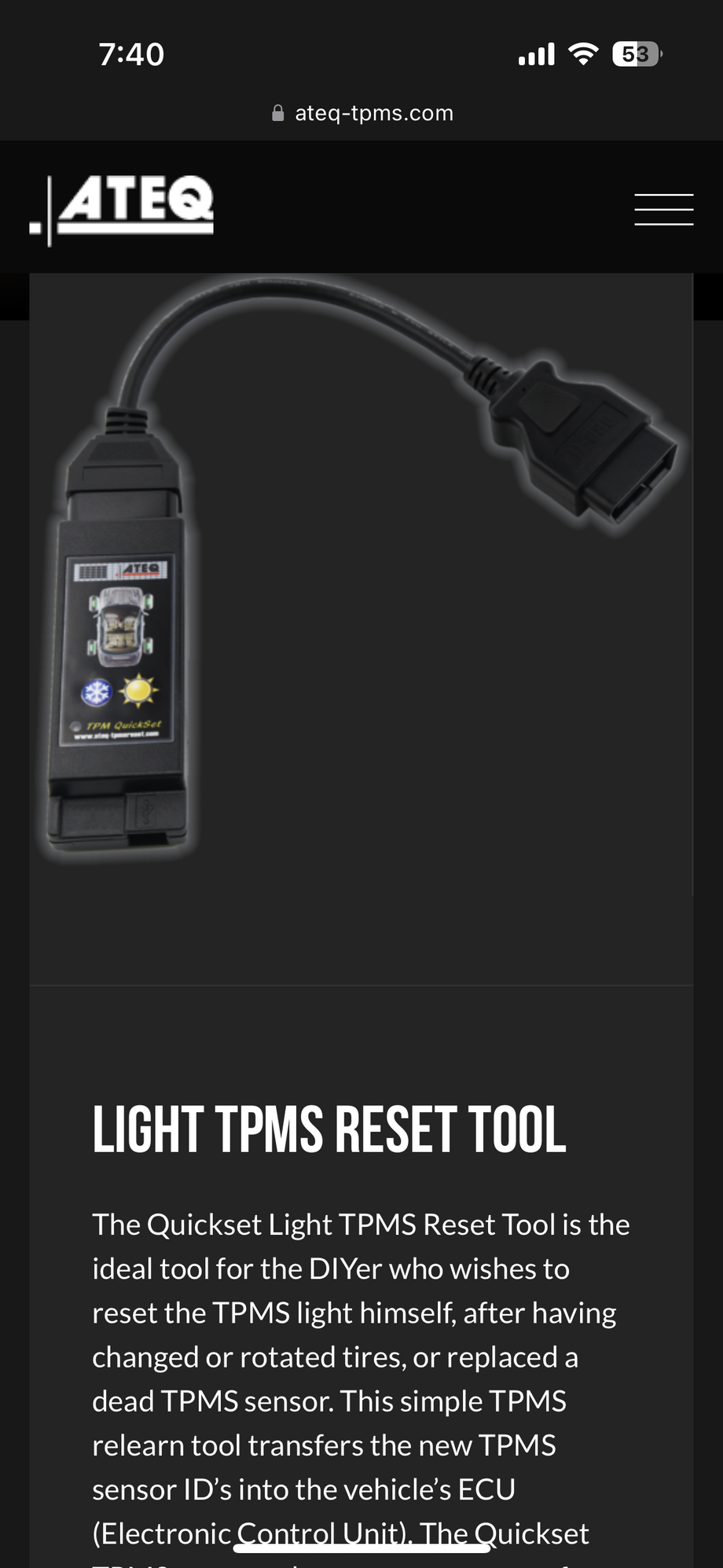

kj07xk's Avatar
kj07xk
Joined: Jan 2016
Posts: 1,192
Likes: 414
Originally Posted by Oro
This feature became a dealer done procedure, taking it away from being free to now a paid requirement.
I refuse to pay someone for something so simple, especially when I swap the winter/summer wheels/tires myself. Bought an ATEQ Quickset tool about the same time as I bought my winter wheels/tires. I’m sure it’s paid for itself some time ago, in both time and money.
