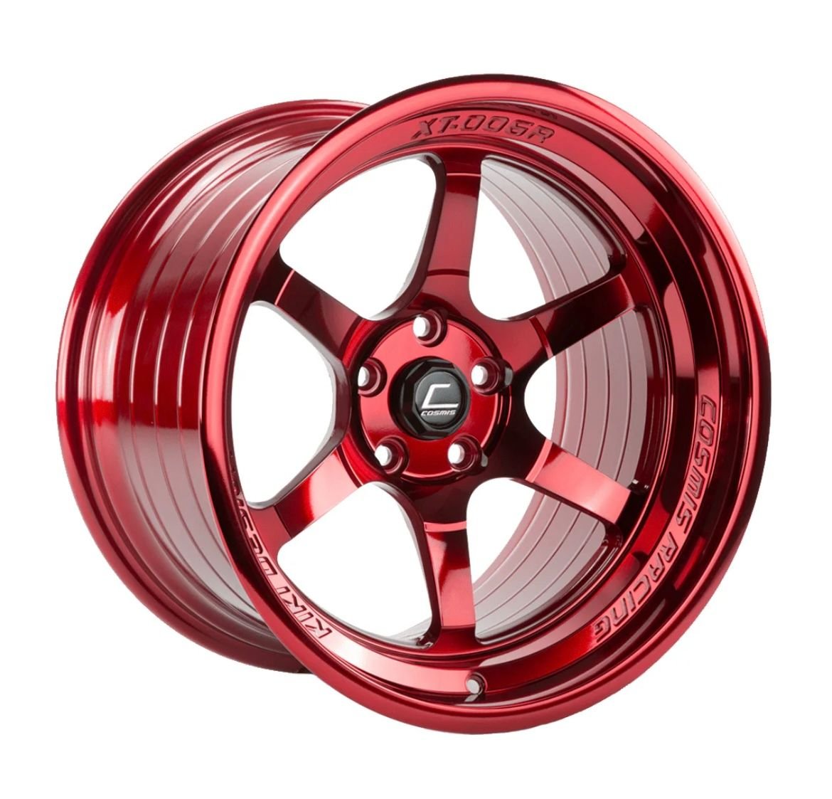

Hey guys! I’m new to this site and slightly new to my IS. I got her back in Dec 2023 and I’ve been loving it.
I’ve done a few things here and there but now I’m stuck on wheels and tires…
I too made an account here to hopefully get some answers and join in on the community.
I have a 2014 Lexus IS350 F-sport RWD
I am lost when it comes to finding the right rim and tire for vehicles unless it’s something somewhat near the OEM size.
The wheel I’m looking at
is the Cosmis XT-006R in Hyper Candy Red.
They come in 18x9.5 +10 or 18x9 +30 for the 18 inch wheels. I would really like the wheel to have a deeper look which is why I prefer the +10 offset, but I'm worried the wheel will poke out too far in the front and I’m not sure if they would cause any other issues besides a 1-2 mph difference in Speedometer reading.
Would these fit right? Along with 245/40 in a square setup?
Also, I’ve been considering getting RSR Downs so idk if I need to worry about that with the wheels rubbing.
