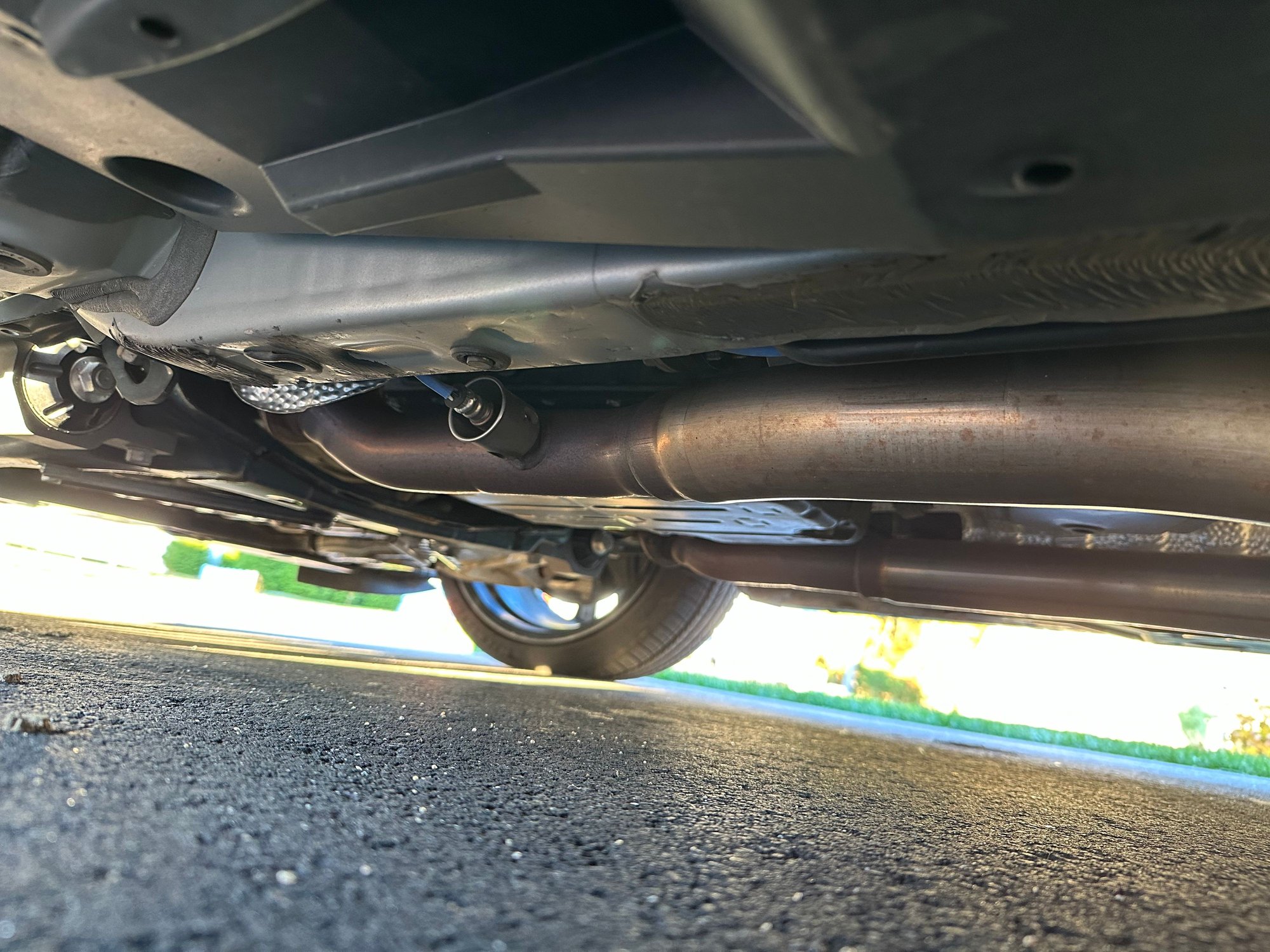

This is where the rear jack stand will go on the metal frame rail. Make sure it is centered.

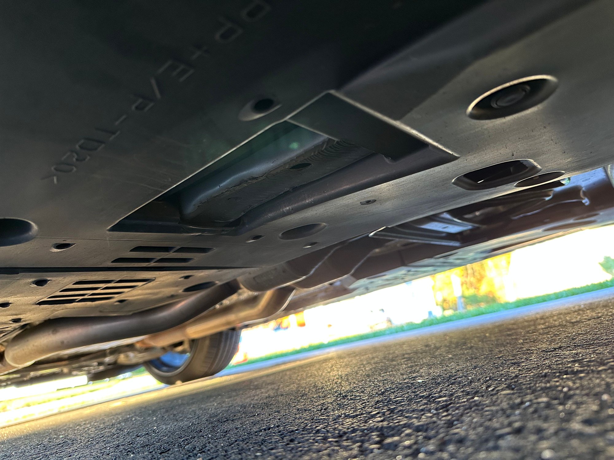

This is where the front jack stand will go I put the jack as far right as it will go and jack it up this will lift both front and rear wheels on the side you are jacking up put the front jack stand right across from the blue wire coming from the 02 sensor and make sure it is centered in the silver frame rail I always give the car a small shake before I crawl under.
