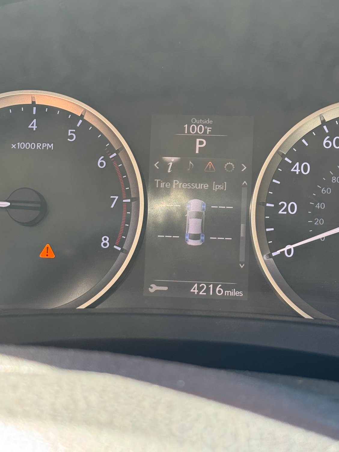

If anyone has an info or suggestions to help.
All tires pressure is OK, check multiple times.
Tire pressure has been reset.
Tire pressure will randomly read for all 4 tires then stop. Turns on about once ever 1-2 weeks.

Looks like you TPMS sensors are running out of batteries. Are these original TPMS? How many years since you replaced them? I believe you are supposed to replace them every 8-10 years.

My '16 GS just started doing the same thing.

Had the same thing happen to me. TPMS will likely last around 10 yrs before the battery die.
Unfortunately you can't replace the battery. You will need to buy a new TPMS sensor.

It sounds replacing the sensors fixed the issue?
Yes it did.
If you end up doing the same, buy OEM TPMS.

You can also get it from Denso directly. Please double check the part number matches your car model.
