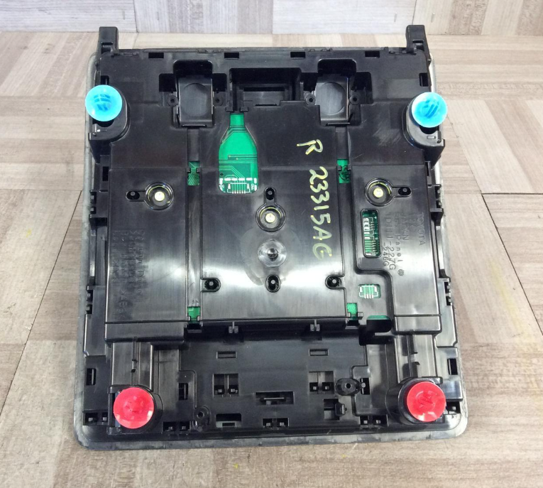

Originally Posted by laobo979
All you have to do transfer your old clip over to the RC one simple as that.
You mean the blue ones? Looks the same to me, am I missing something?
The two red clip need to be removed and replace with the one from your original map light clip.
Thanks for your help! I will report once I have installed it!

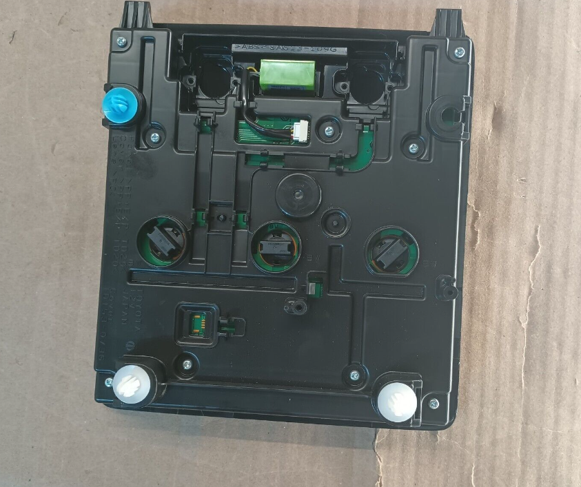

@laobo979 & @swaangin I just got the RC dome light assembly. I swapped the red clips with the original white clips and....it does not clip . I don't know why, because the position of the clips seems the same, I have the impression the clips housing height might be different, and the clips does not reach the counter holes in the ceiling crossmember. I have pushed hard and it does not clip.
The blue clips clip without issue and all the buttons function as intended (although the center light does not stay on more than a couple of seconds when I touch it (it does when I open the door), which is odd).
I think I am going to leave it as it is for today, it was a long day I am tired. Maybe tomorrow my luck changes.

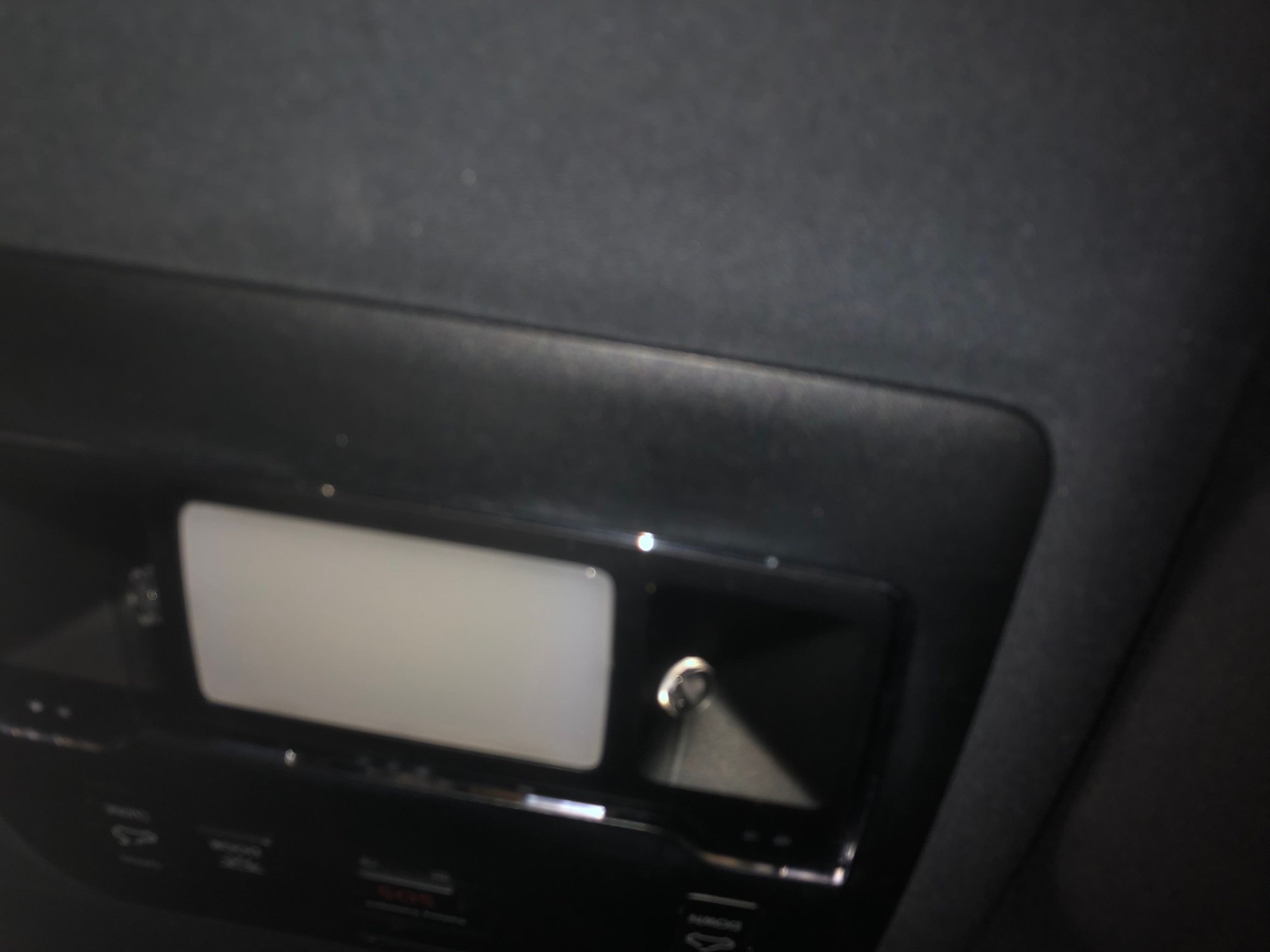

Seem odd as I have RC installed over 4 yrs with no issues. All I did was swap the clip as I told you and no issues. Let see some pic and sure the clip not smashed? Here how mine looks as you see no issue.
The issue is on the other side (windshield side), what you show is also clipping in my car.
I shortly tried this morning, I was able to feel what I think was the white clip fitting in, but it did not stay in place. I will start from scratch again after working.
I did smash some blue clips yesterday (but I replaced them with the ones of my old dome assembly). Is possible to buy replacements? White & blue clips, just in case.

If you look at the my pictures that the windshield side. Cause the switch side is toward moon roof.
You are absolutely right, for one second I thought I was being full retarded mounting the thing backwards xD, but no, I was just confused by the picture

@laobo979 @swaangin Hi, short update, so, yeah, the white clips were busted. I ordered new clips but in the meantime I realised the voice commands were not longer working and the bluetooth was only recognincing my smartphone as a media player (and not as a phone). When I tried to re-setup the bluetooth connection I kept getting the same error.
So, one of two options, parts are just not compatible or the junkyard RC dome light I bought is defective (which I doubt because the bluetooth was able to play music).
Re-installing the original dome light solved all the issues.
I just decided to leave the original dome light and buy Philips Ultinon Pro6000 W5W T10 LEDs now that I have the old dome assembly out of the car, which makes the replacement very easy.
