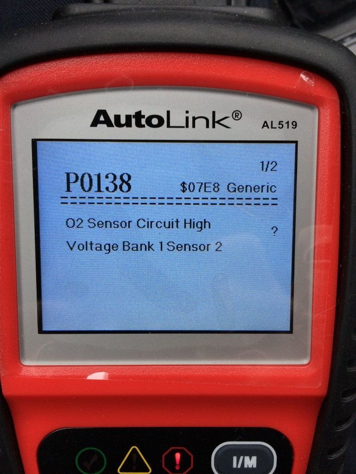

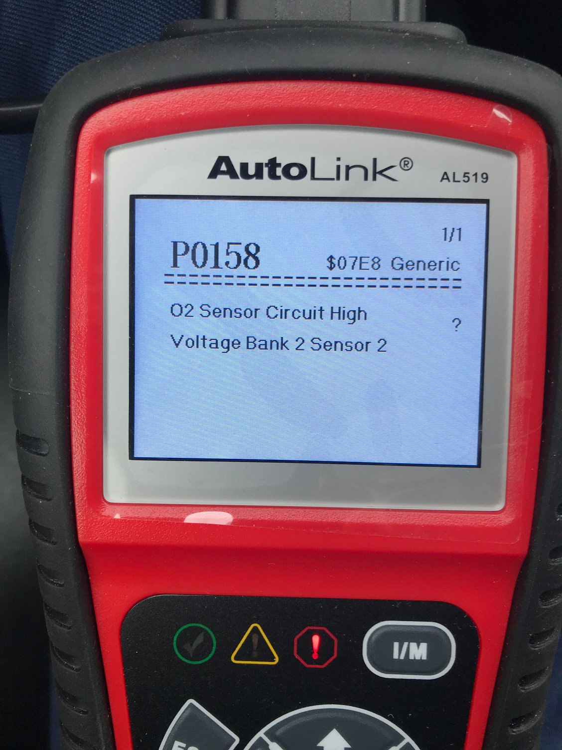

If P0138 code is for the downstream sensor passenger side and P0158 is for the downstream driver side, I figured P0420 is for the upstream ones, either passenger or driver side. I could be wrong though.
Does anyone know what Circuit High means?

High means the downstream sensors output is pinned against the rail. IDR which sensor this is (there are 3 main types) but typically it outputs +/- 1 volt max, so if it's +999mV for a couple minutes or longer, it throws those codes.

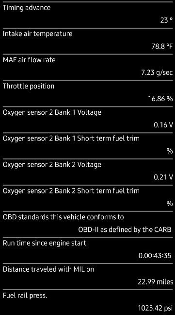

Idk how to interpret any of this but this is what I pulled from my OBD II

You have a Rich condition going on. Look at your FUEL trims all negative numbers.
What mods do you have on the car? Catch can?, Intake?
What work was recently done on the car?
