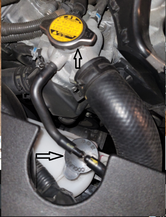

Though pictured above, it was not mentioned. The "radiator" cap might want to be replaced. Many, including myself, have found theirs over time have separated and are in pieces just sitting inside the housing there.
Also, if yours leaks, think about a replacement overflow cap for the overflow tank.

Thank for pointing that out Gville350. I included the cap (part 16401-31650) in the photo to reference along with the hoses, but forgot. Thanks for pointing out the overflow cap (part 16405-31040 ???). Will add both to parts list.
