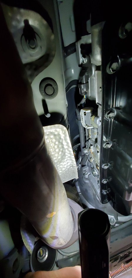

I'm not going to bet my life on it, but this may be it right here. Left side on my A760E which may not be the case on your A960.
Single bolt, black sensor towards the rear.
