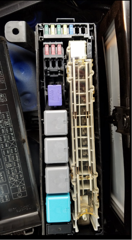

Perhaps an issue with the 80A fuse PN: 82620-30170 (located in the fuse box under the hood near the battery) , per 2013FSport's reply # 5 here;

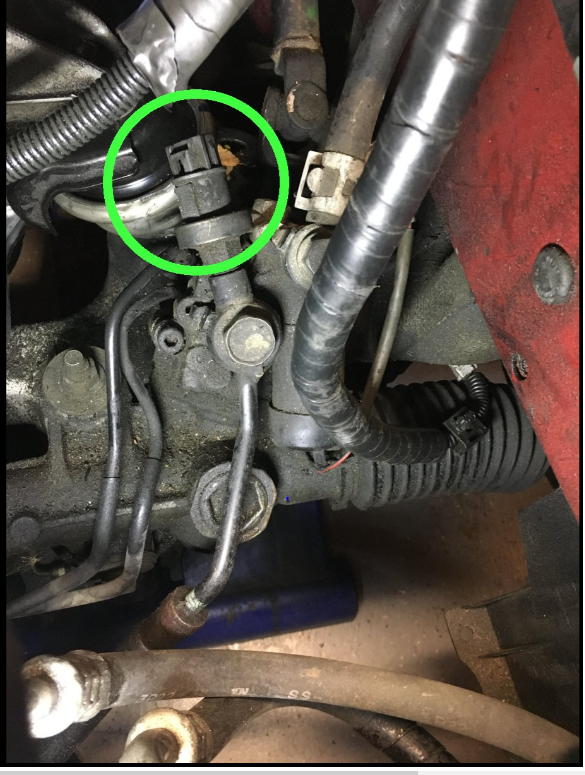

Or maybe defective / loose electrical connector on the steering rack (SC- 1st Gen shown circled in photo below);

As for the 80A fuse, there would be no assist if that pops.

Dude, that's hydraulic R&P... Not the same. But ya, OP said they checked connections.

Yeah, understand it's a photo showing hydraulic power steering rack and pinion (not electric). Photo was just to provide an example of steering rack connecter / location (had easy access to the photo).
