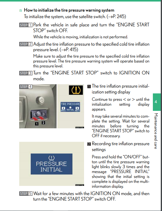

May have to initialize the tire pressure system, by using the "satellite switch", located to right of steering wheel. Unsure if pressure to be set will be shown (35 psi front / 38 psi rear);

TopNotchIN, thank you for providing the additional information regarding the TPMS system installed. I appreciate it! If I understood correctly, ,would it be a good idea to perform the initialization procedure as outlined in owner's manual, soon after having tires inflated to the correct recommended psi (35 Front / 38 rear)?

ELexis, yes that's correct. Just wait for the sensors to complete the cycle of initiation. The TPMS lights will eventually go away. I always have my tires serviced at Costco and they refurbish the TPMS with a kit whenever they replace the tires. If you are a Costco member it is the best place to get your TPMS sensors replaced anyway. Good luck.

@ELexis You can initialize the TPMS right after inflating your tires or you can wait. The main idea is to have the tires at the correct pressure and initialize the system while the tires are cold. When you drive your tires will heat up from the friction produced by the tires' resistance to the road surface. That heat will raise the tire pressure slightly because hot air expands. If you have an air pump, fill your tires and do the TPMS procedure before you take the car for a drive. If you have to go to the gas station to fill your tires, go directly after that car has sat for awhile so that there is minimal heat build up in the tires. Remember to adjust your tire pressure according to the weather in you area as well. Why? Because cold air will lower your tire pressure. If you will experience some cold temperatures you will need to adjust the tire pressure to compensate. For example; the current weather is 50 degrees but it will be 20 during the evening. You will need to add 3psi to your tires recommended pressure. Tires lose 1psi for every 10 degree drop in temperature. Just check your local weather and see what the lowest temperature you will experience that week. Adjust the pressure according to the current temperature and the lowest temperature you will experience. Take the number and adjust pressure accordingly. Hope that helps!

Adjusted the air and received it again. Both times I did not go through the initialization procedure, which I only realized after reviewing the manual. PSI must have been set lower than the recommended settings however, as you stated, there has been changes in temperature that may have added to the issue and causing the warning light. After recent adjusting trip for air, I added the correct amount all around and performed the initialization process as outlined in the manual, and not light since. For a while, I was concerned that perhaps on of the new tires, TPS sensor or wheel had become defective, not realizing to perform the procedure after inflating tires to correct psi.

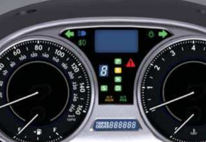

When both the following warning lights are ON with "LOW TIRE" displayed in center multi-information display / cluster;
Does it indicate that there's an issue with part of the TPMS system (defective sensor etc.), or just that the tire PSI has fallen below the predetermined PSI set by factory due to change in temperature, slow leak due to tire or wheel etc.?

LOW TIRE means the tire pressure is low. Nothing wrong with the TPMS system.

Understood, thanks for the follow up nosurprise, I appreciate it. Have received the warning lights with LOW TIRE message often over the past months. The temperature has fluctuated and may be the cause for low pressure. I've not encountered this as much with previous vehicles equipped with TPMS. Am going to add an additional 2 PSI to front (37) and rear (40), then perform the initialization procedure immediately afterwards.
