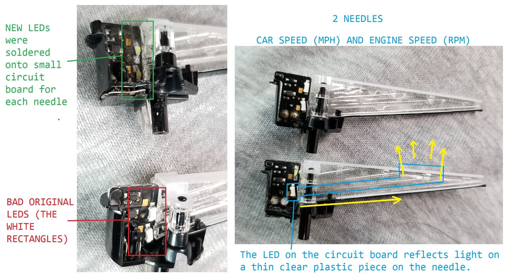

Each needle had 4 LEDs. If one of the 4 go out, then the perceived light will be dimmer. Over time the LEDs will go out. In my case, Most of my LEDs went out so I went to a computer repair shop and asked them to resolder new LEDs on the needles, and it worked out well.
I just got my LEDs replaced "good enough to see" at a small computer repair shop in Philadelphia, PA (Mega CompuTech) that was willing to take on the task. All this shop did was resolder replacement LEDs for me, and I took apart the instrument gauge cluster and pulled out the needles. I first attempted to solder the LEDs myself and gave up after many hours of research and a few hours of soldering failure. My IS250 is 13 years old and not worth much, and although TaninAuto's work looks excellent and their dash disassembly instruction was great, I decided to attempt to get the needle's LEDs fixed at a small shop for cheap before committing to buying replacement needles from TaninAuto. I'm sharing because the tech/owner Manuel was nice enough to give it a shot, and since he's in Philly on the East Coast, it might be beneficial for some of us. I wrote a good review on Google since I was pretty happy with the repair. Call a nearby computer shop that can do soldering, show them some pics to see if they're willing to try, then good luck! YMMV.
