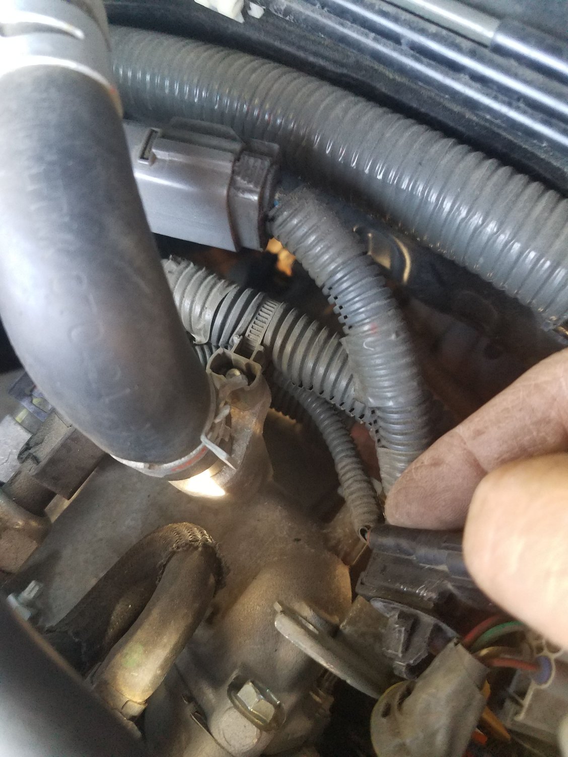

Can you be a little more specific when you write "no crank"? Does the starter engage ? Or does the starter engage and the car simply not start ? You could be experiencing an issue such as weak battery, Immobilzer/security system, bad starter, failed fusible link, bad fuse, failed fuel pump, etc., etc., etc. Always start with the simplest which is the battery then I would suggest Immobilzer system. Perform the Lexus recommended procedure of using the fob to push the start button, if still no start then replace the battery in the key fob and attempt a start and progress from there such as this:
I just went through a no-start condition on my 07 IS350 after I inadvertently let the battery get weak after not driving the car for about 2 months. The car did start but I made the mistake of turning on the seat warmers while idling as I waited for my wife. Because the warmers are a high electrical draw item and the battery was already weak, the charging system apparently couldn't make up the deficit in electrical power at idle and the car died most likely because the battery voltage dropped too far. Realizing my mistake, I turned the seat heaters off but there was no way the car would restart, it wouldn't even turn over and even the self test lights were dim when I tried a restart. I load tested my battery and it was at 8 volts and I was surprised the car even started the first time but it obviously had more than 8 volts in it when I initiated the first start attempt because it started but the seat heaters pulled too much out of the already weakened battery and that was that......
I put the battery charger on the car, we got in the truck and ran our errand. After charging the battery, the car did not recognize the keys (door locks didn't work, etc) and from there on it was a major pita trying to diagnose the issue. The battery was fine but I purchased a new one anyhow, replaced the batteries in the key fobs, did the key reset procedure (car would not crank using the keyfob to press the start button) and it seemed as if the immobilzer system did not recognize the key and the Owner's Manual doesn't give any clues on how to properly diagnose the issue but I performed the Immobilzer reset procedure as above anyhow. The car would still not crank but car recognized the fobs now but would crank let alone start so I disconnected the battery, checked all the fuses that may create a no crank, no start condition including the fusible link. All looked fine. After reconnecting the battery (resets the ECU) the car would start momentarily but die within a second or two and would then not even turn over with subsequent start attempts. Disconnecting and then reconnecting the battery would result in the same, car would start once but not run and then not even turn over. That told me the fuel pump was working or it would not restart during subsequent attempts as well as the ignition system being operational. It seemed obvious to me that a sensor of some sort was putting the car into a no-crank condition after an initial start attempt and it turned out to be the fuel pressure sensor which is screwed into the back of one of the fuel rails on the back of the engine. I have no idea what caused the failure or why and can only assume that maybe the low volt condition caused the failure or perhaps the failure was only coincidental with the dead battery, I don't know.
I got the idea of the fuel pressure sensor from a Youtube video I found and the mechanics explanation of how the sensor is wired into the electrical system. A failure will not throw a code and can prevent the car from turning over and of course, not starting. It's not a difficult job, and the sensor is a common Toyota part # 89458-30010. I purchased a $30 remanufactured sensor with a lifetime warranty off of Ebay along with a pack of 10 crush washers, Toyota # 90430-12026 for about $20 and I was glad that I bought the 10 pack of washers instead of only the one needed as I removed the sensor once when I had trouble getting the electrical connector snapped back together and there is very little room with which to work. I suppose I could have reused the washer but didn't want to take the chance. Here's the Youtube link:
Here's another excellent presentation on accessing the sensor. This car is an IS250 but the engine architecture is very similar to the IS350 and the procedure is essentially the same.
There's not a whole lot of information about this no-crank, no-start condition that is peculiar to the fuel pressure sensor failure but replacing the sensor on my car resolved the issue and car seems fine now. I also purchased the intake manifold gaskets along with a throttle body gasket but mine were in excellent shape so I simply reused them. My total parts cost was approx $80 dollars and in terms of removing and replacing the fuel pressure sensor, about two hours of my time. I could probably do the complete job now in about an hour. I spent far more time trouble shooting and trying to figure out what was wrong. I had also had a lengthy conversation with a mechanic and service advisor at an independent garage that specializes in Lexus service and had I been told of this particular oddity in these cars it would have saved me a lot of time spent online trying to diagnose the issue. It was suggested that my starter might be bad as well as a bad fuel pump but I found both of those scenarios unlikely especially since the car would start after resetting the ecu. I certainly thought about throwing in the towel and getting towed to the nearest garage but I knew it was extremely likely I would wind up having to pay for a bunch of parts replacement because technicians/mechanics sometimes simply start replacing parts instead of properly diagnosing the issue to begin with. I'm glad I persevered and I got lucky finding the Youtube video of the "no-start no communication" video. Good luck with resolving the issue. I hope this post has helped or at least given you an idea or two.....
After
