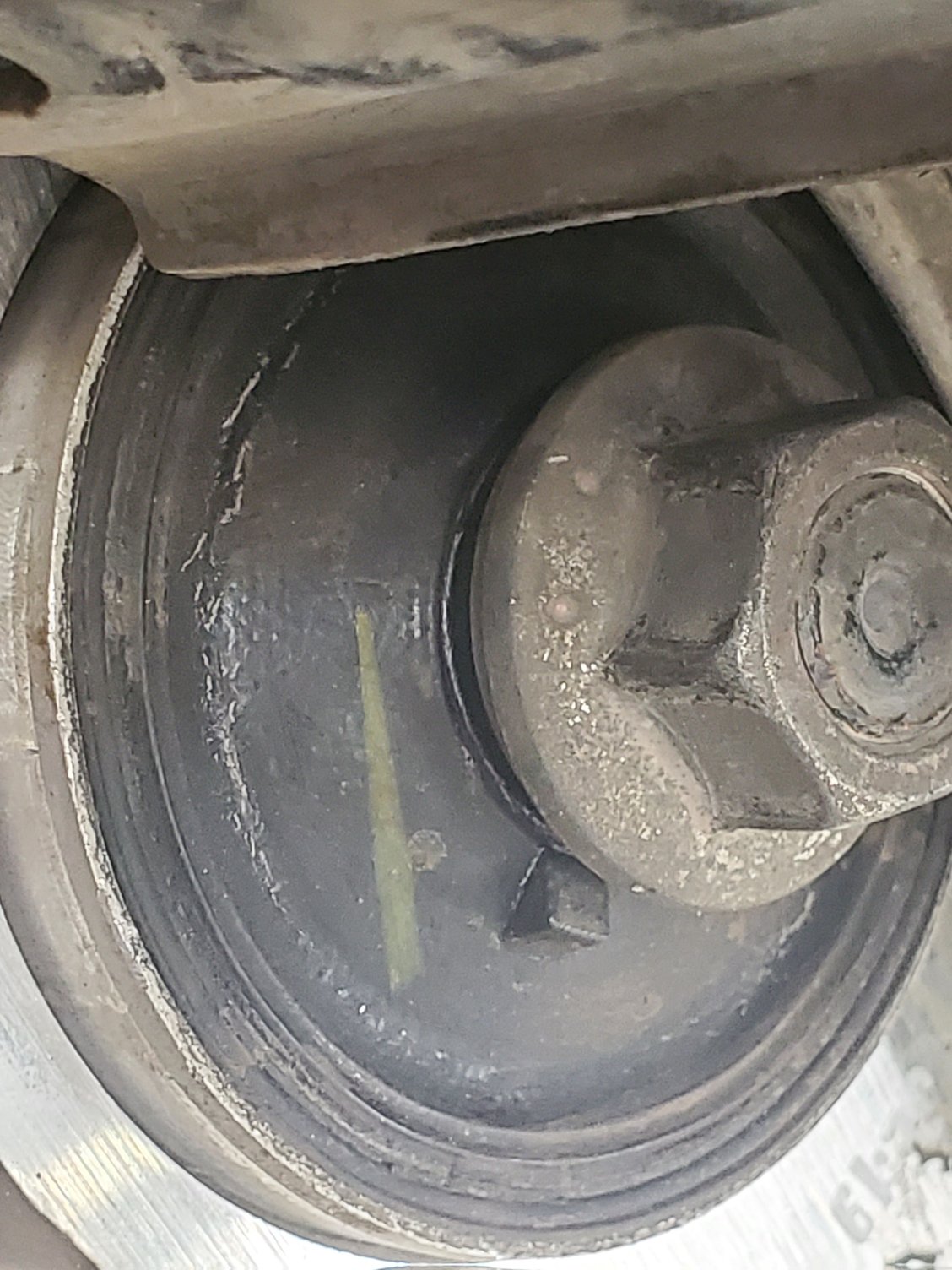

Got it on a lift today and this is how the new bushing looks

Ok took it to a shop which the tech diagnosed that the right wheel is 14mm behind. So he recommended to get a new control arm to solve the issue.

Unless both the upper and lower control arms were pushed back nearly equally (nope) I call BS as the caster is too high at 7.9° on the RS.
Seriously get a tape measure under there and compare side to side measurements from equal and opposite unibody plug holes to the lower ball joint. They are accurate and were used to build the car. To determine if A-Arm is bent, measure to subframe. Its cast aluminum and won't bend far without breaking. Once again, keep in mind that one can shift the LCAB which WILL MOVE the lower ball joint and change the caster slightly.
