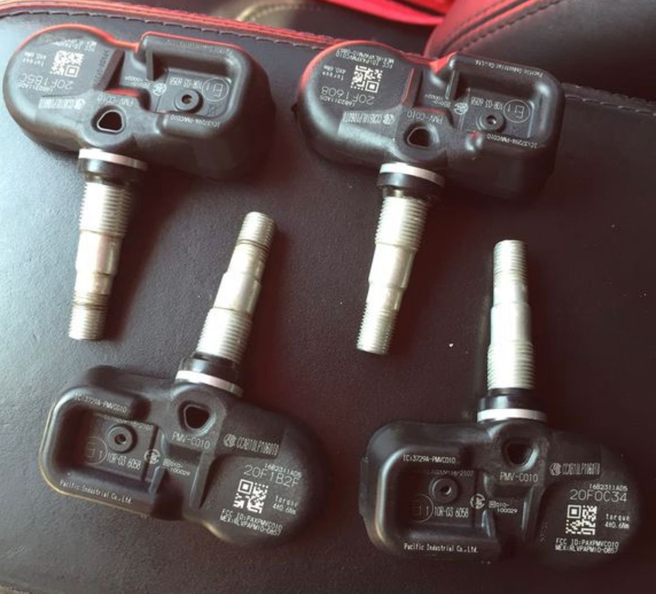

I am looking at purchasing a set of 2014+ IS 250/350/200t Factory TPMS sensors. Will they work on my ‘09 IS350?
Will be replacing tires soon and would like to replace the TPMS sensors as well and want to know if these would do the job before I pull the trigger and purchase them.

They won't.

So the TPMS sensors that I should be looking for are OEM 42607-33021, 42607-33022, or Denso 550-0103?
Below is a picture of 2014+ OEM IS TPMS mentioned in the original post.
Lexus 2014+ IS 250/350/200t Factory TPMS sensors

3IS sensors will not work on a 2IS from my own personal experience.
I even made a thread about it here:
https://www.clublexus.com/forums/is-...atibility.html

OEM sensors that Toyota, Lexus, Scion use are made by Pacific. Sensor model used in 2IS is Pacific PMV-107J, or Toyota 42607-33021
If you look close at the picture above you'll notice that these were made by Pacific as well.

Thanks for the all help guys. Will look at getting the Pacific PMV-107J, or Toyota 42607-33021 sensors.
