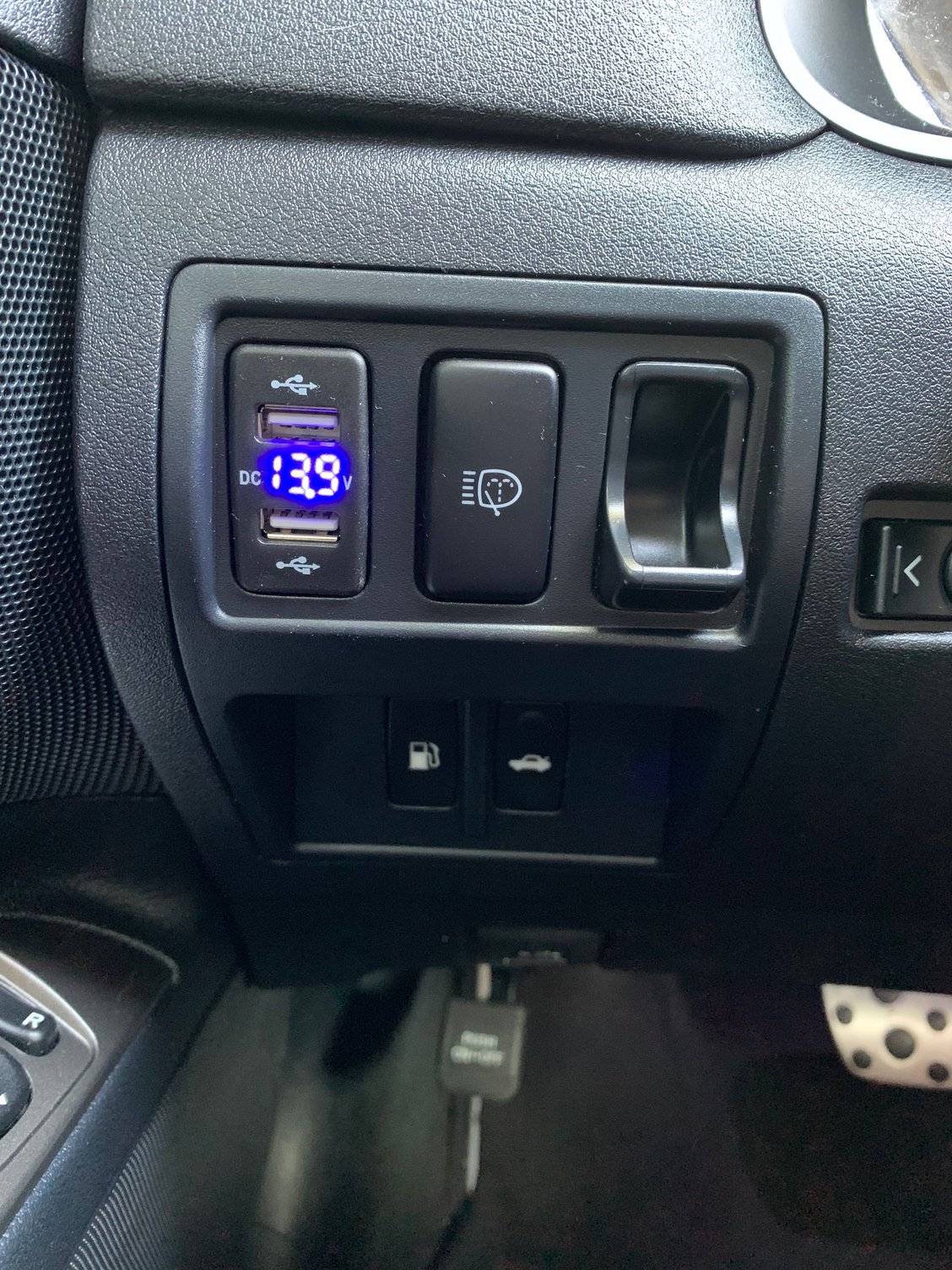

I always like knowing what my voltage is. I finally had some time to wire it. Only had it installed for about a year.

Now that’s neat. Details of the purchase and install please. This is a value add installation.

These are pretty popular in the motorcycle community where charging systems rely on induction and have limited output, are easily overloaded etc.
One sample; put in Toyota USB digital voltmeter.
https://www.ebay.com/p/25022151703

Where did you tap for the power source?

The fuse box under the drivers side had 5 open fuse holes. 4 ACC, 1 constant. I used a add a fuse ,only put a fuse on the wire side. Installed on ACC. I didn’t want to send power to a circuit that doesn’t need power.

Bussman makes a piggy back fuse that works great. Used one on my bike. A good product.
Max is 10A so be careful where you double the load from.

Thats the one I used. Didn’t use it on a fused hole.
