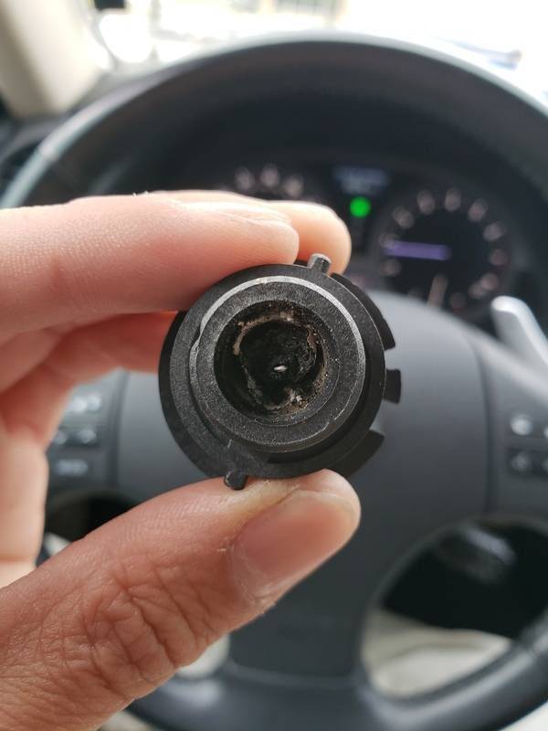

I recently bought a new ballast after my passenger headlight started flickering and then eventually died. The new ballast I bought was a xenon one off amazon. After the install (this past weekend), the headlight was working again but I could still see ever so slight flickering. This morning before work I was checking to see if it was still good and it turned on for a moment then died. Popped the hood and could smell a burning odor. Popped the bulb out of its location and the connector inside is melted/fried. The ballast wire cap is also fried. Just seeing if anyone on the forum knows what happened.

Was the plug disassembled? We are talking High Voltage here and one tiny strand of either wire left uninsulated and in close proximity to the other would lead to arc-over and subsequent meltdown.
All it needs is a path of least resistance and this could happen. It could be failed insulator or material defect but more likely is workmanship.
Perhaps cut it back and install one of the old used plugs and see if the ballast is still alive. Tho this may have impacted its reliability. Be careful...

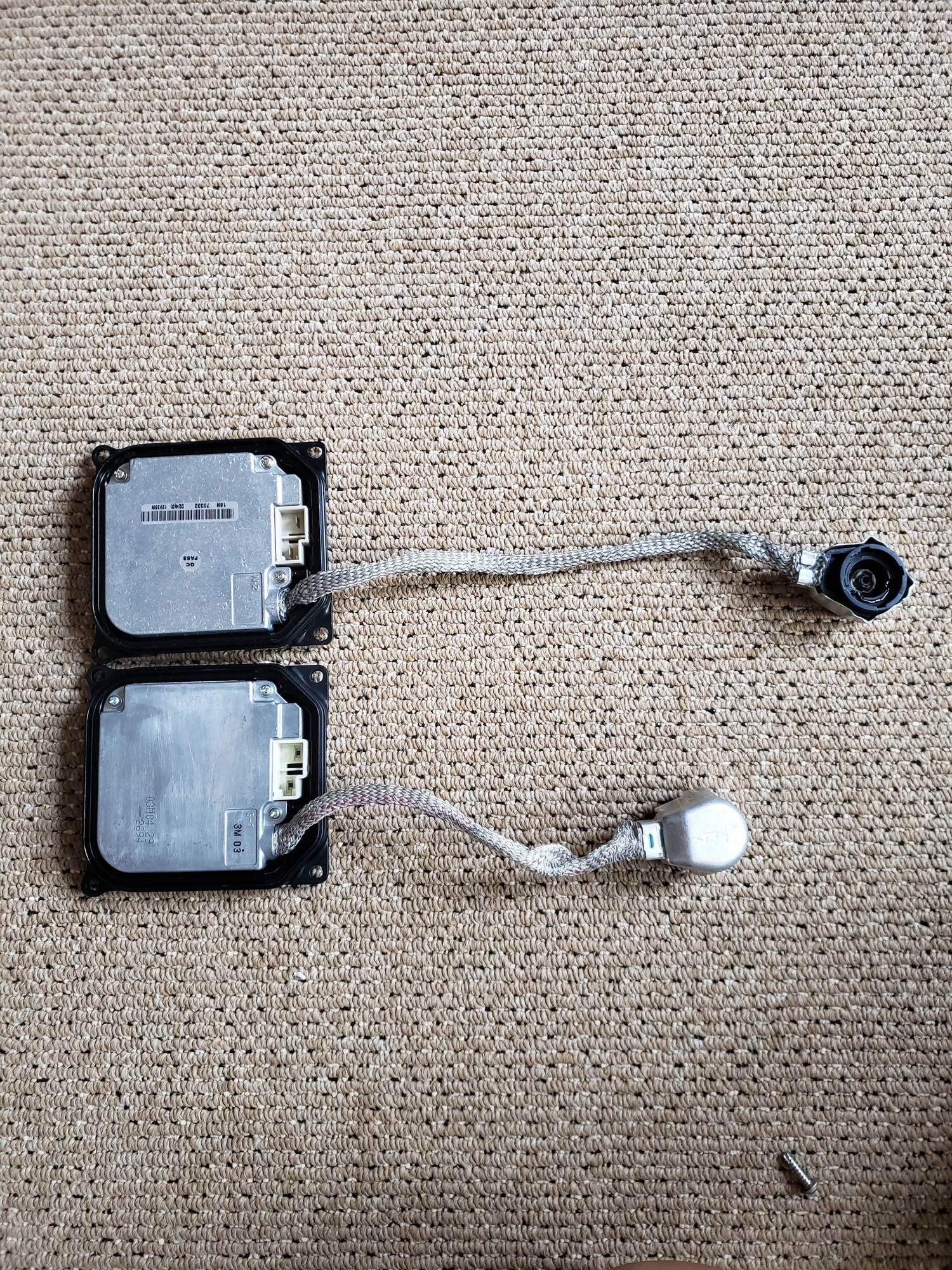

Switched out to an OEM ballast from toyota and headlight is working again. GenXenon was the brand that failed but already shipped it back so didnt check the model number. Not sure if it makes a difference but below you can see a pic in the difference in play of the wire from the GenXenon brand on the top and OEM on the bottom.
