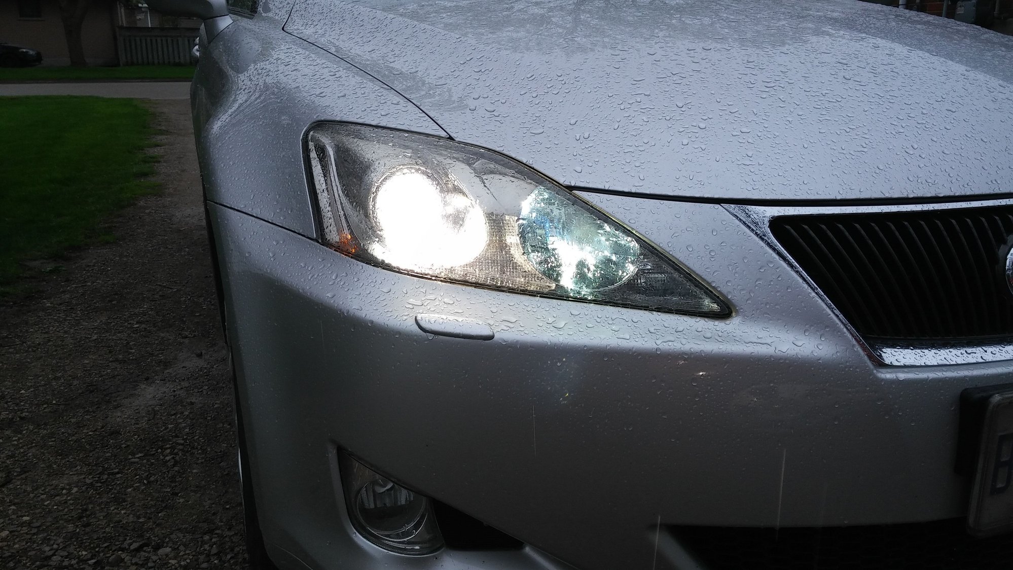

So i decided to order some new bulbs (Morimoto 4500k from TRS) as the ones i bought the car with were becoming quite dim and too blue for me. I installed the new bulbs the morning and the passengers fire up perfectly and looks great, but my drivers side does not turn on at all. My first thought was oh great i got a DOA bulb and switch them from side to side and sure enough both bulbs work perfectly in the passenger side. So next i put one of the old bulbs in the drivers and left one of the new ones in the passengers, they both fired up no problem. So i know its not an issue with the new bulbs. My only other idea is that maybe the ballast in the drivers side is dieing out and cannot supply enough power for the new bulb? (i dont exactly know how ballasts work, etc so that may be a silly idea) If it helps, my driver side housing has had a problem with moisture building up inside since i bought the car a year ago. If i should try a new ballast that would be good since id want to take the driver light off anyways and open it up and re-seal it up. If anyone can offer some input that'd be awesome

Thanks for the responses guys. I do not think it was a seating problem as i removed and put in each bulb (both the new ones and both the old ones) in each light multiple times as i was getting frustrated lol. Each set of bulbs do work and fire up. the problem is that the new ones will only fire up in the passenger headlight but not the drivers. The old ones will fire up in both headlights, i put each bulb in each headlight and then reversed it, both old bulbs will work in the drivers side no problem. I replaced each bulb the same way. they have the markings at the base that "align up" to the slots on the projector housing and are snug in there good. The socket slide on no problem and locks into place no problem on each bulb. Aspect, the drivers side worked no problems before this and still will work with old bulbs in it.

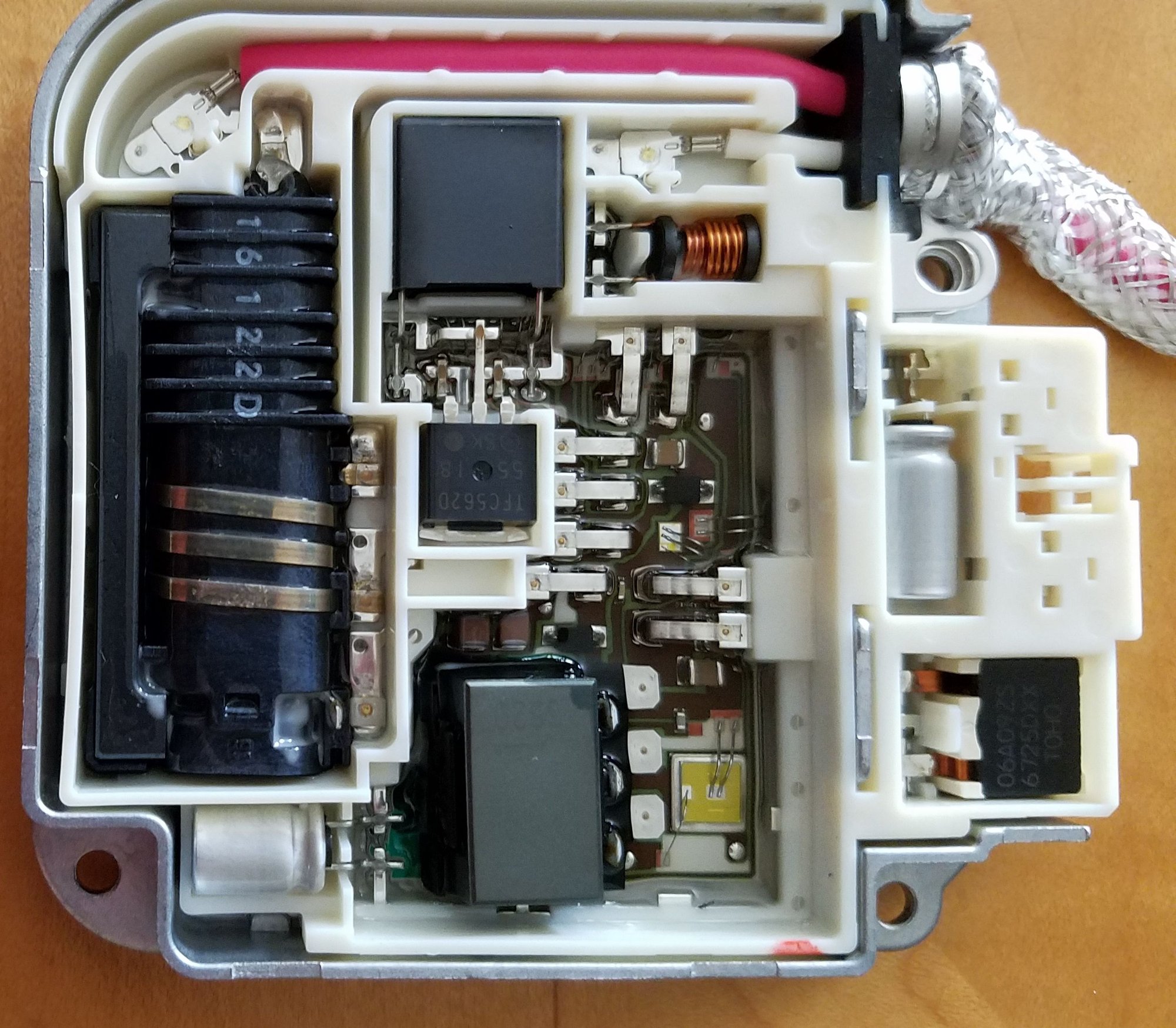

Thanks for the insight guys. My IS is a 2008 with the luxury package (standard HID with AFS). Yesterday i made use of the nice weather and took the light out to give it a good look over. Ive definetly come to think its th ballast. It is majorly corrded and all caked up with white and orange crust...looks pretty nasty. I seem to always have some moisture in my headlight for almost a year now since i bought the car (who knows how long it was liek that before i bought it). Im now looking for a OEM denso ballast, trying to find a new one at a good price, most i see on ebay/amazon are pretty cheap but i think are used off scrap cars (still could be fine) but i prefer a new one. Xenondepot says they sell only new denso ballasts for 120 which isnt too bad. I'll have to heck out Yoda. Its the 85967-52020 D4S that was on the car already. Sinister, thanks for that vid will be really helpful to waterproof the new ballast! definetly dont want this to happen again.

This looks like conformal coating that was used in areas to reduce shock. And if you look close you notice the output to the bulb is spot welded into the circuit. Thus, as stated above, the lights connector has to come apart to get the ballast out of the housing. JM2C but the only reason i can think of for not potting from moisture is heat dissipation and cost. Heck, coastal areas rich in salt air would hurt the OEM design over time....
