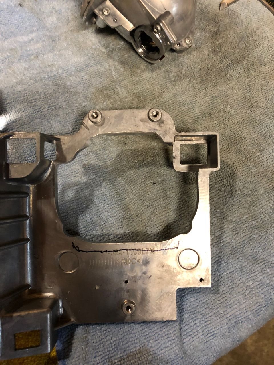

An update on the Depo light retrofit .. I shot the reference lines on the Depo Halogen bulbs in relationship to Hi Low Beams. I removed the projector, and cut out the material where the New Projector will set into position flat against the internal mount. I will upload pics when I have to completely fitted. There are screws passing through the sides edges on this projector and I am relieving this area for the screws not to cause the unit not to set flush 'Flat" against the mount. It was late and I came inside and let my compressor cool off. So far so good... better than expected. I have the new D2S projector positioned up down, within 1/32 of the lens being centered like the original one, next is left right and then rotation.I should test fit later today, late morning early afternoon and fit the lens and see how It aligns, Fingers Crossed.... If lens matches up I will drill the mount holes and slot them some, to be able to tweak rotation after installing on the car without sealing up the lens. Get the cut offs aligned with each other, then close up and reseal the lens.
Later today, I should know if this is going to work and look correctly.
I am also installing Bluetooth controlled RGB Demon Eyes on these projectors as something different. Cell phone controllable and endless color selection.
Like always the 1st one takes the most time. Once I get this one done, the next should proceed a lot faster.

Here are the Pics as promised. I fit the new Projector and laid in the place the Lens Bezel and see where I am at. I started by measuring the center of the Orig proctor to a known point at top and laid the new projector in and marked and ground out the area to allow the projector to be centered up down, then mark around the bottom to be cut out.
Lens and Bezel laid in place
Hey there room for the projector to move
Just the D2S projector laying in place not drilled
In place and clearance between the bulb and housing, It will need a hole to access the bulb, and maybe exit the wire or use a 90 and keep them inside and exit to the ballast somewhere else.

Here are update picts of the Projector retrofit project with New D2S 4.0 Projectors in new Depo lights
Demon Eyes RGB kinds with Bluetooth Controller..
Bolted on Number 6 screws for wiggle room... inches of Horizontal Adjustment is needed... Taped and threaded into the mount
The "HOLE" i was concerned and tried avoid cutting and almost using a LED Projector and decided not to and go Full Monte HID The hole is 2 inch and I can remove and replace the bulb through the hole. The 2 1/2 hole I was panning for did not fit well in a flat area to us a boot and seal up.
Finished look, before mounting in the car and conform Horizontal Cut Off alignment matches the other side then Install the lens!
The straight connector used for the HID Bulb and how far it extends out the back, The good news it appears to be ok, but I can move the entire mount forward because there is room to the lens bezel it appears.
