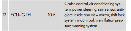

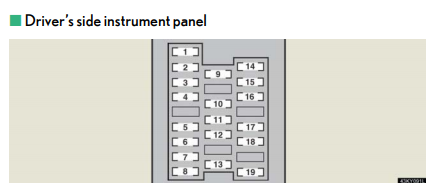

Does anyone have the fuse descriptions?

Have you popped the top off of the fuse boxes? IIRC, there are fuse diagrams in the lid. Not sure about your vintage.

Yes, I have popped the top off of the fuse boxes, however I was looking for a little more detail. FYI, I just found that you can actually download a PDF copy of the owner's manual directly from the Lexus website.

Ok, well I found the fuse descriptions in the owner's manual I downloaded. I replaced 1 fuse and now all my warning lights are gone and I am back in business. I do have to find 1 more fuse to replace to get my interior lights back, but at least I have power steering and A/C.

jr4div2,
No problem. So I actually had to replace 2 fuses. The 1st fuse which was in the driverside fuse panel (Under the dash) fixed all my warning lights, Power Steering, Shift lock issues, VCS etc.
The 2nd fuse I replaced just fixed the interior dome lights.
Although, I did have one weird issue. I had another 10A fuse that was located under Fuse 9. I'm not sure why it was there. From the diagram, there is nothing that would require this.
