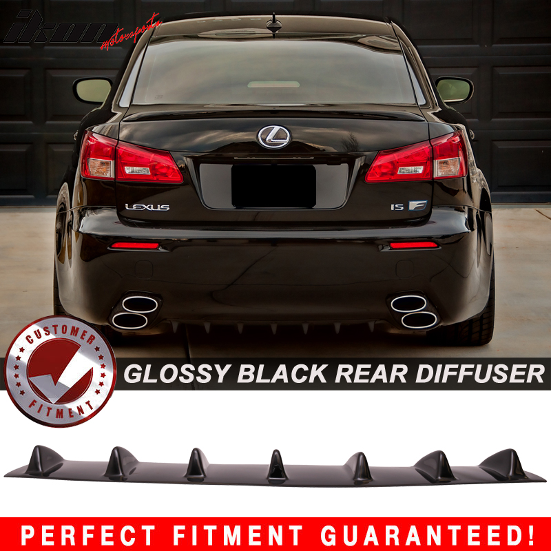

Just ordered the other style rear diffuser in gloss black. It installs with 3M tape but in looking under the car I see there is a plastic panel already there--I will have to see if it fits over that.

got mine from ebay too. I prepared the surface very well, put additional silicone, used 3m and place it with the help of my mechanic (you need a hand you cant do it alone). within few minutes it starts coming off because of a cheap product only 70% fit i guess. Ended up with screws coz there was no Ctrl+Z. Its there for more than a year now and you dont feel the screws. Very happy with my decision to put screws in.
I strongly suggest to put screws! if not now but in winter it may came off, better not to take risk.
That looks a lot like the S4Play Diffuser. It comes with and installs with screws. I used tape also, but the screws make it much more secure. I tighten them up every month or so.
https://www.clublexus.com/forums/is-...-diffuser.html
S4Play is a member of this forum. This forum is a wonderful resource, if you use it. If you had used the search function (it works very well on this forum) you would have found it and saved yourself a lot of trouble.
