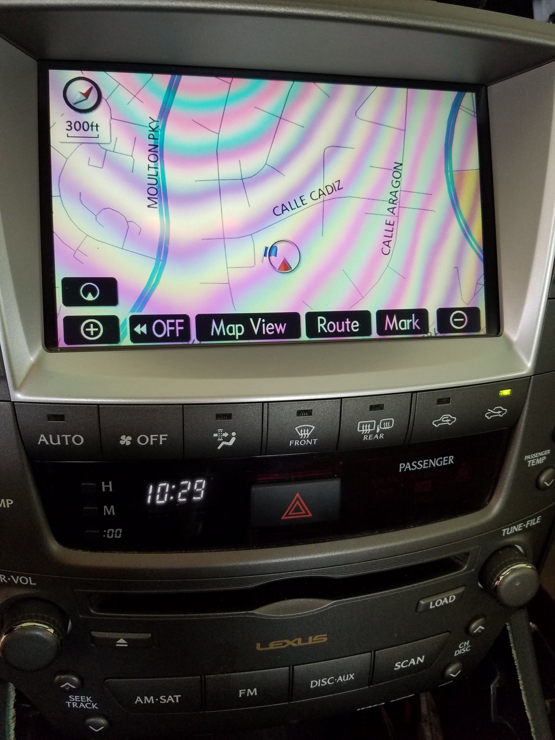

Fixing up or replacing the touch panel is not hard at all. The only thing you should paid attention on after market touch panel is rainbow effect. I've seen some car has that problem already.
I recall someone saying that the rainbow effect was caused by someone leaving on the plastic on the panel.
There is no protecting film on it at all. I double check it when he came to me.
