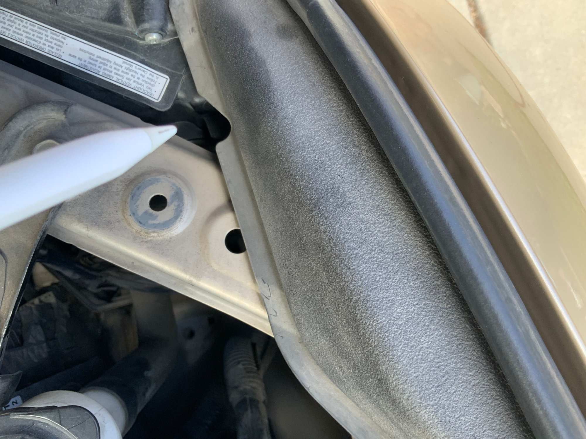

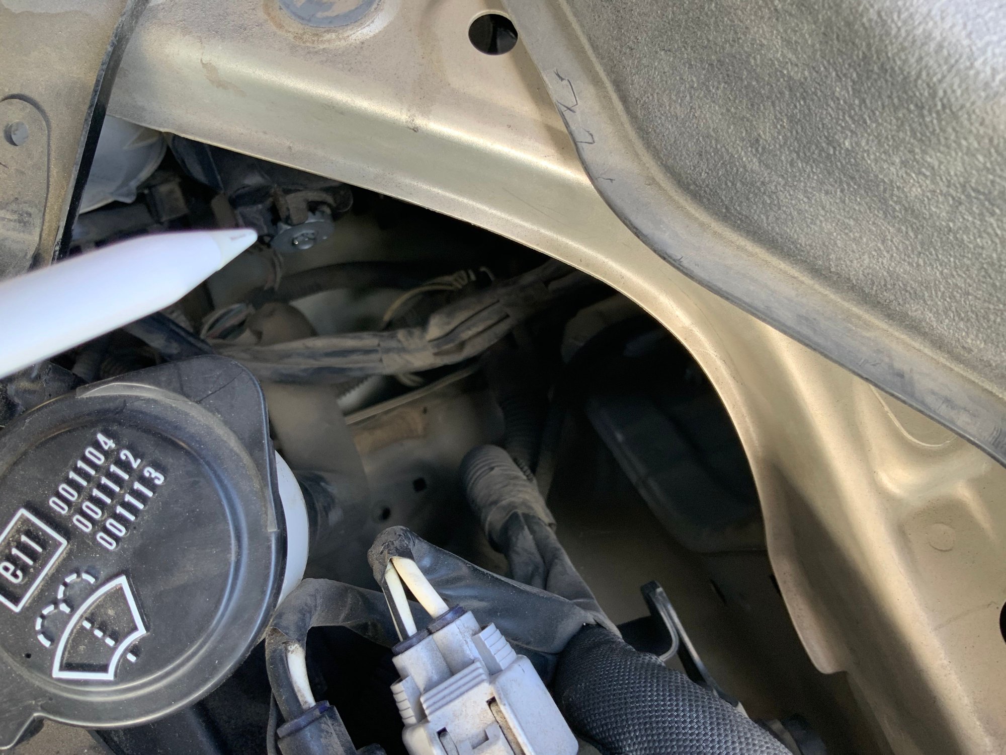

Default 450h screws are in a different place
Originally Posted by Fuzzie
just remove your engine covers and use a phillip screw driver to adjust your low beams. there is one bolt on each headlight and a spot on the bolt to put your screwdriver to adjust. just keep twisting till you get the height you like.
I have spent 2 times using the standard rx pictures as to where the screws are 1 is as shown the other is in the back of the light assembly.
the diagrams I have seen online show one in a completely different place.
