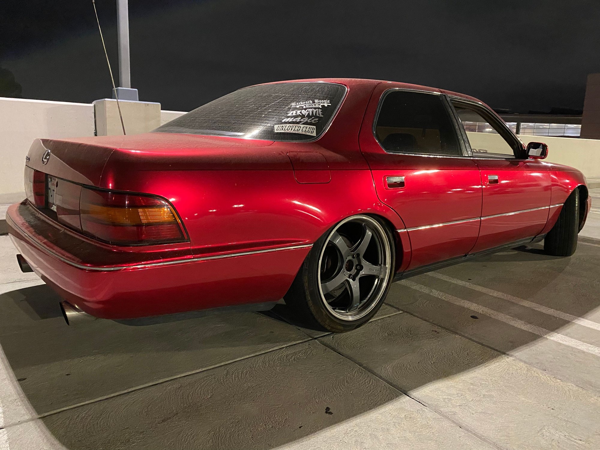

Originally Posted by kilo6_one
mods, if i posted this in the wrong section please move.......
im intrested in getting some g-games barracuda rims for my IS, it currently dropped on eibachs and have 19"s, my question is can i run a 10.5 out back with a 40mm or 32mm offset? I have 19x9.5 now with a 32mm offset and it looks like i could go another inch........
anyone with in knowlege in this area?
I run the G-Games 99B on my LS400

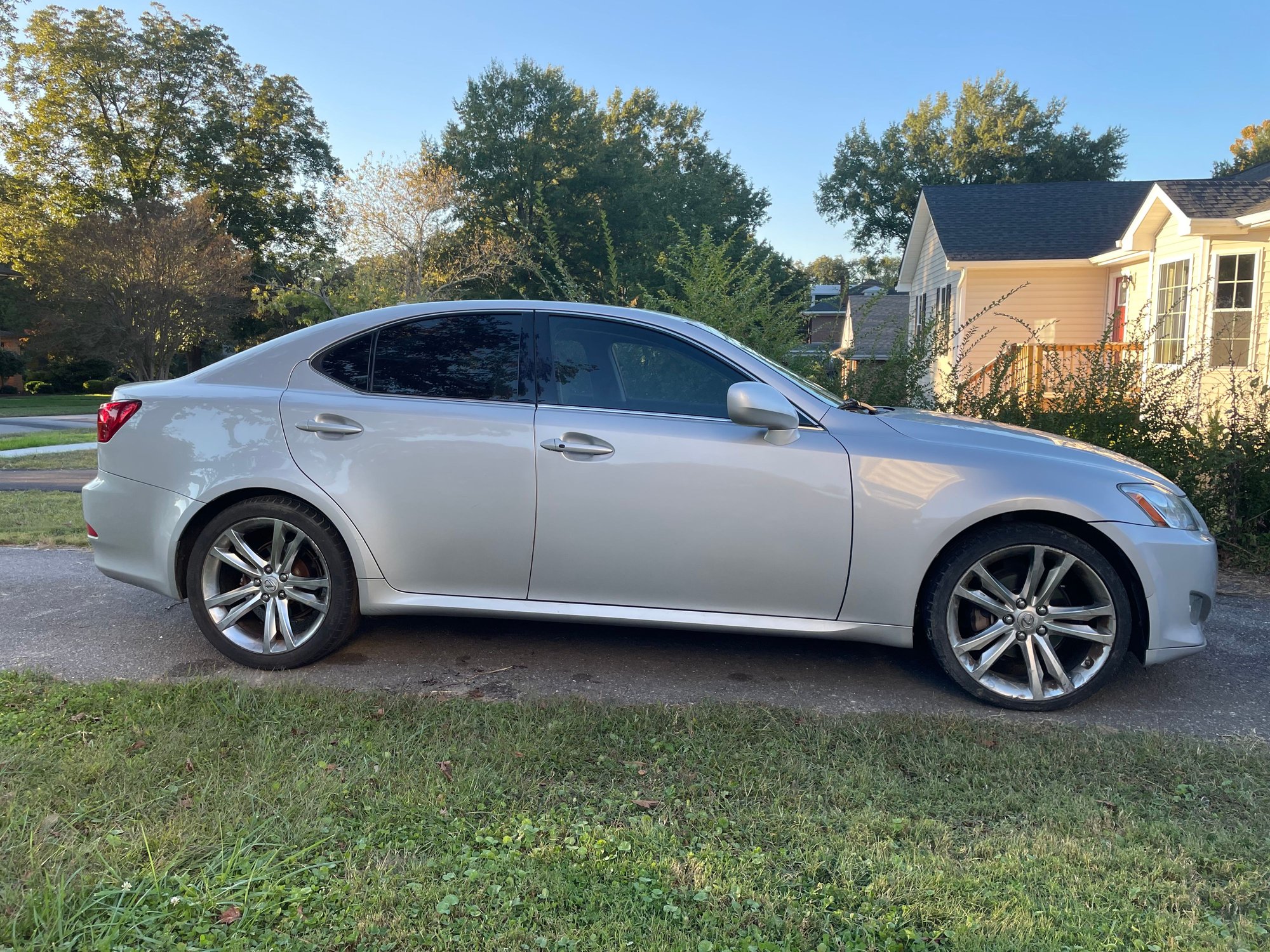

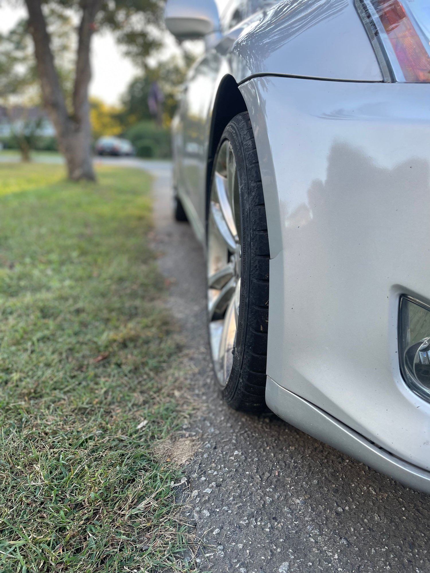

Default Wheels fitment query
I got Yokohama Super Advan SA3R wheels and want to put them on either Lexus Is250 or Altezza/Is200.
Front Advans are 215/45/17 7jx17 ET35, meanwhile the backs are 255/40/17 8Jx17 ET35.
The 2007 Lexus IS250 stock rims are 225/45/17 7Jx17 ET45. According the willtheyfit.com the front Advans will be 10mm further away from the suspension strut & the backs will be 2.7mm closer to the suspension strut. Similar reuslts for the Altezza...
My question is will they fit or spacers will be needed?
* Btw has anyone here put Advan SA3R on their Lexus IS250?
Thanks

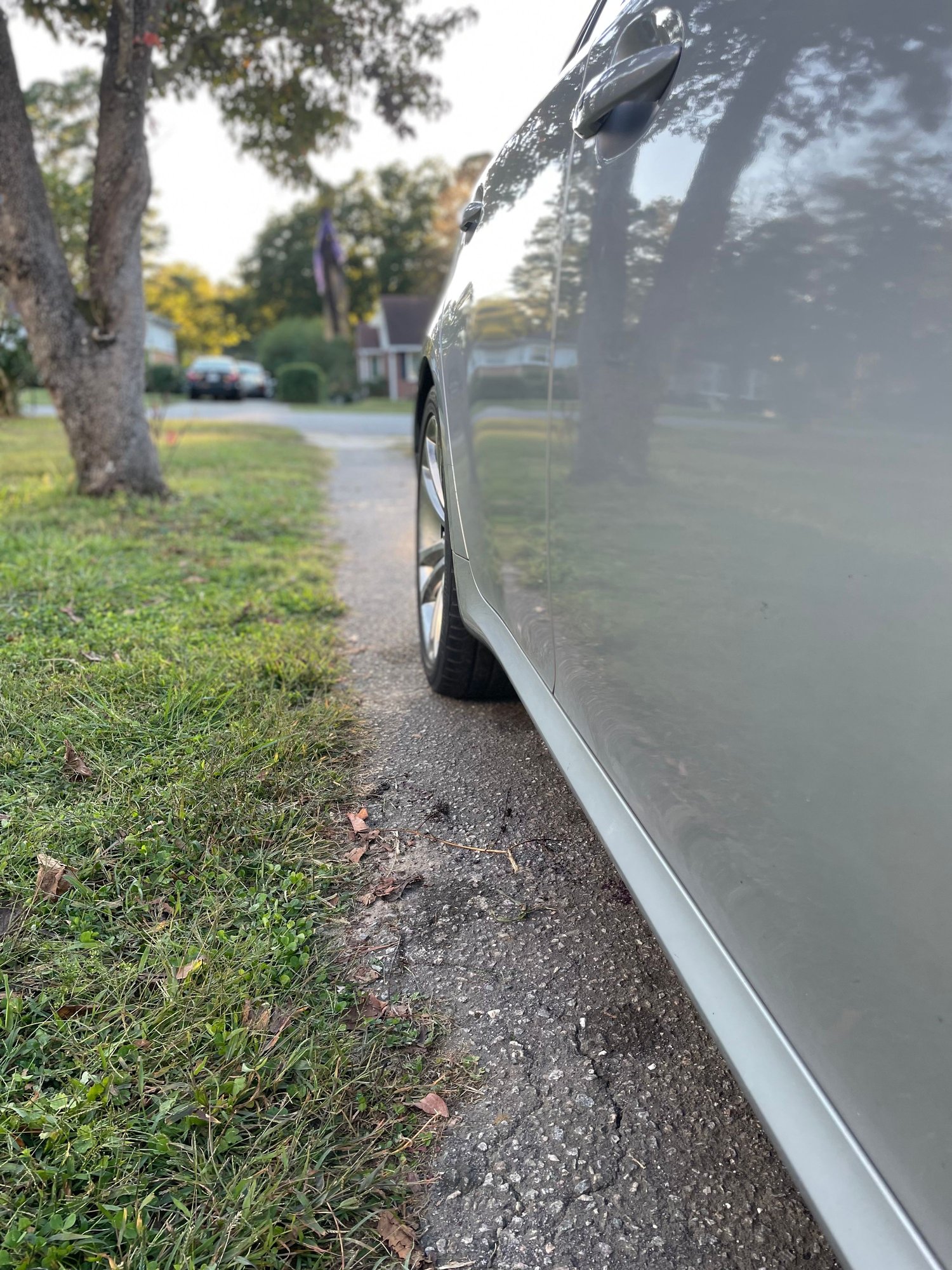

Hello,
I have a 2008 IS350 lowered on Tein S Tech springs (Drop: -1.6" front, -1.2" rear, according to Tein website)
I currently have 18x8.5 +30mm wheels and want a square tire setup. Does anyone have a recommended tire size for this setup without rubbing issues? I have seen 18x8.5 +35 and +40 setups with H&R springs , but those offsets give the front wheels ever so much more room from the front fender liner.
Please advise! I would greatly appreciate the help.

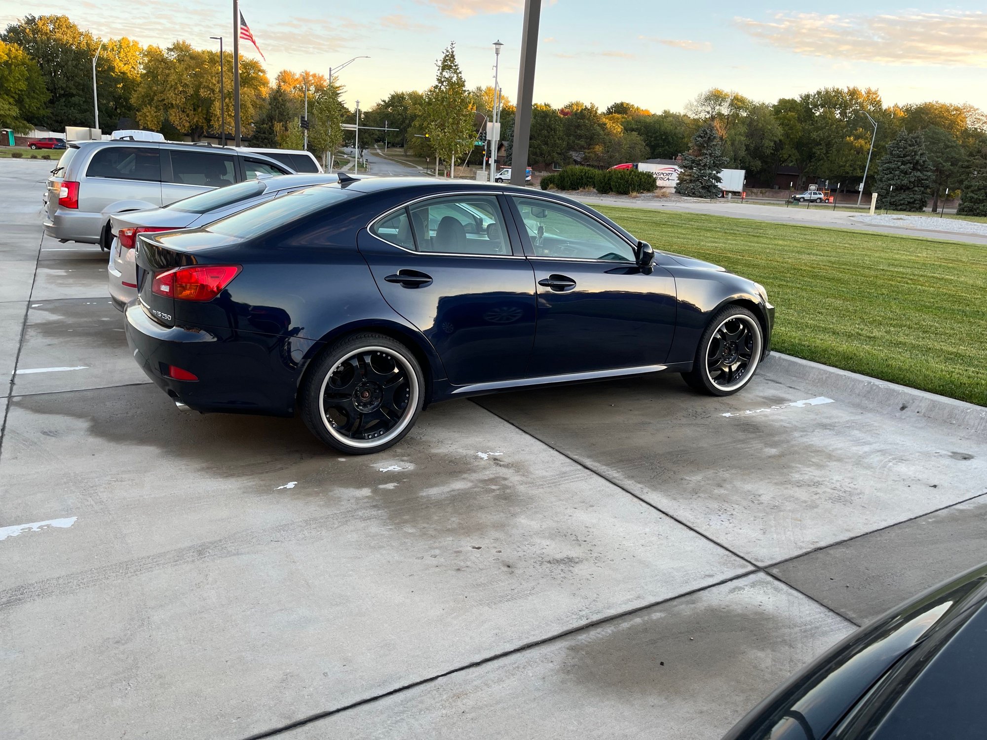

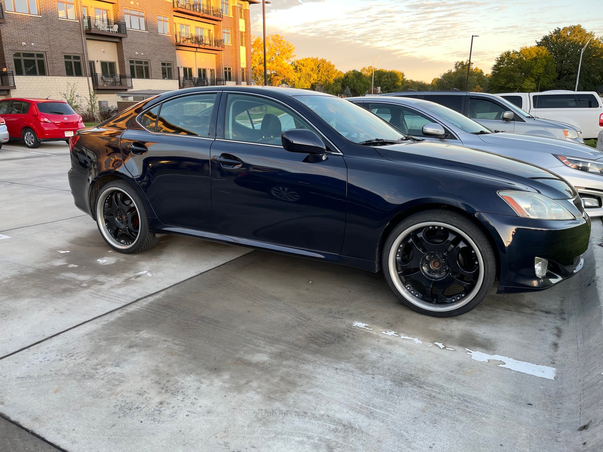

Old Oct 14, 2022 | 07:15 AM
  #5729
RealRyan's Avatar
RealRyan
10th Gear
Joined: Oct 2022
Posts: 13
From: Nebraska
Default 20x8.5 wrapped in 225/30
Will it fit?
Yes it will!
