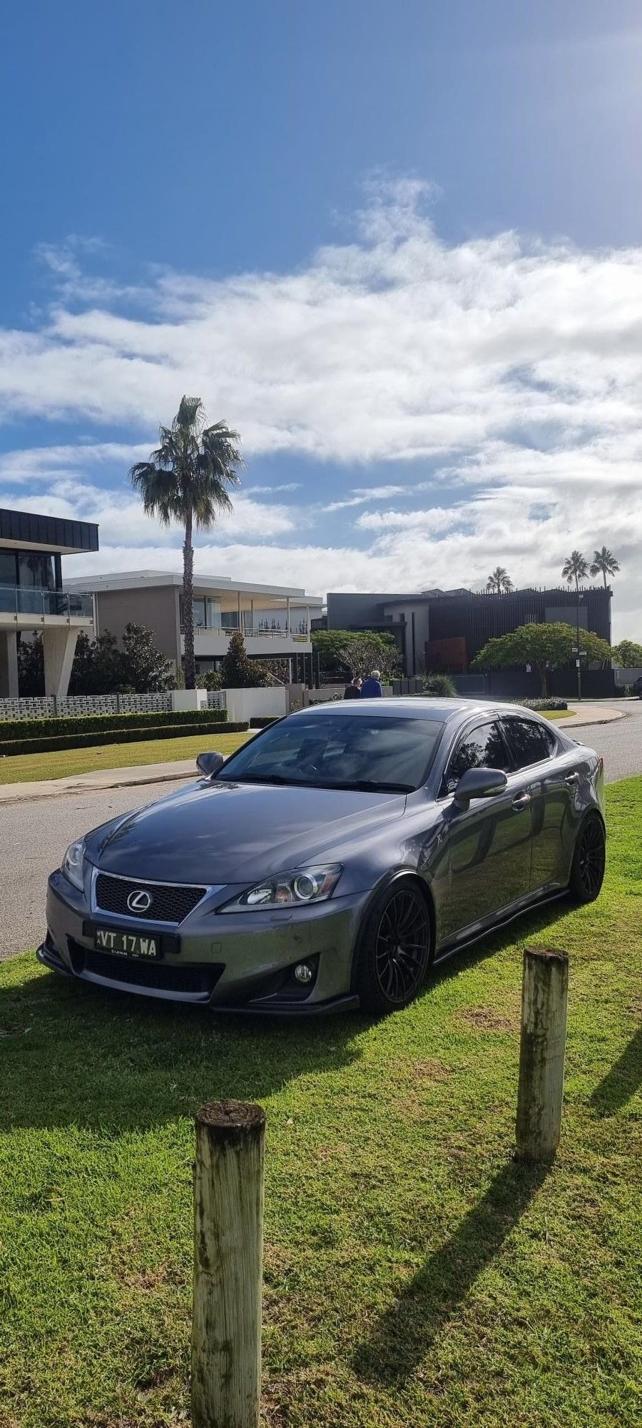

Likes: 30
From: Perth, Western Australia
Im running 18x9.5 +38 square, 5mm spacers front ( as its sitting too close to the vertical arm up front )
245 40 18 front tyres
265 40 18 rear tyres

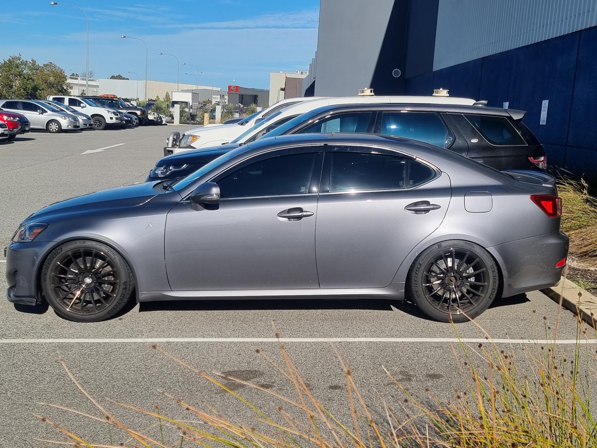

Do you have a photo shot of this car from a side profile? I've been going back and forth between getting 18in & 19in size wheels but your photo keeps bring me back to 18in for aesthetics.

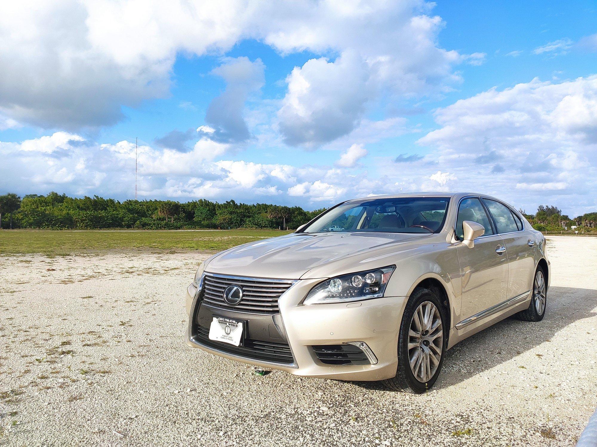

Default 5x120 lexus ls 460 to 114.3 wheels what can be done.
Hey Guys, I need some advice. I have some 22inch Asanti AF128 I had bought for my 2006 lexus Gs 300 and I put them on but the offset was not right for the car and the body of the car sat on the tires. Now I've purchased a 2015 Lexus Ls 460 L and the bolt pattern is 5x120 which of course is not the same as the 114.3 from the last lexus (2006 lexus Gs) model I had. Wondering if anyone has done the conversion from the 5x120 lug pattern to 5x114.3 and if there is any advice you can give me when doing the conversion through wheel spacers if any. Fyi the wheel well spacing is of course much larger on the LS model, so I'm not really concerned with the offset for the LS model. (both photos are below (top photo is the old lexus with the wheels on it, but again they didn't fit once we brought the car down from the lift and again body of the car was sitting on the tires and last photo is the new Lexus LS model. Please send advice.
