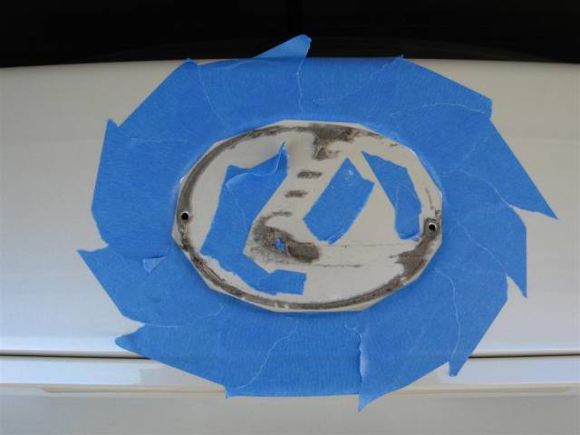

How is the rear Lexus logo emblem attached to the trunk? Just 3M tape? or does it have prongs? Can I safely remove the Lexus "L" logo and then reattach it?
I ask because I'm about to get my trunk lid wrapped in paint protection film at Premier Protective Films Inc.

There are two pegs on the back of the emblem, and this is what the trunk lid looks like after you remove the emblem:

Do the pegs break when you remove the emblem?

Not unless you do something to break them. They're just for lining up the emblem properly.

Any tips on removing the emblem and tape cleanly?
butter knife? haha

Any thin hard plastic will do. Lots of guys use dental floss, but that's not nearly as easy as using an emblem removal tool (essentially a plastic chisel). It helps to use a heat gun or park the car in the sun to soften up the tape to help removal too.
