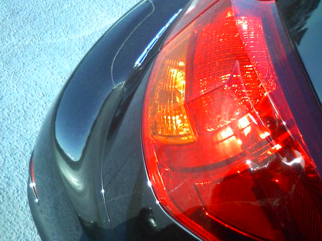

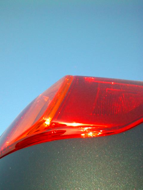

Originally Posted by Joe Z
I will just keep it simple here..
The 2009 Taillights bulge out (a lot more) of the bodylines of the new IS.
Mainly along the bottom of the side-rear fender area and trunk lid.
This bulge is very apparent on both the Inner & Outer Tail Light housings.
You really cannot see the difference from straight on when taking a pic of the rear, so I took some different angle pics that actually show the differences.
Not sure if anyone thought about using these on an 06' to 08' IS or the IS-F, but if you did you would NOT be able to mix and match these housings up, between the different years or models.
I am glad I have my IS-F tails...
Here are my "cell phone" pics
2008 Taillights
My 08' IS-F Taillight
2009 Taillights
Enjoy
- Joe Z
