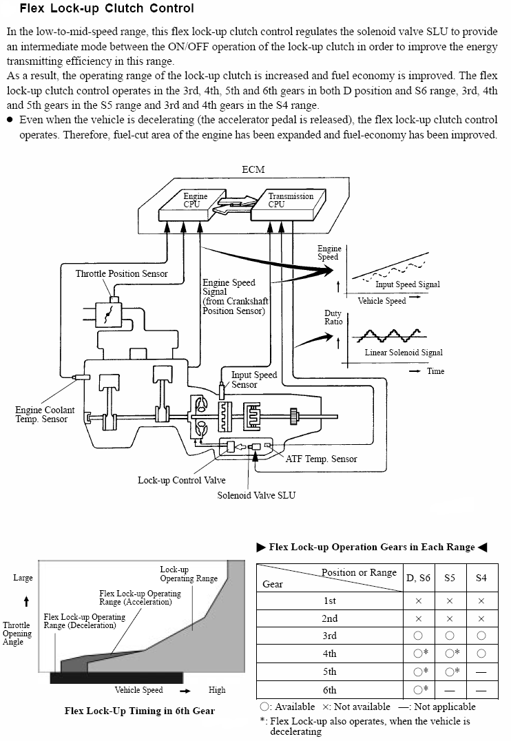

Contrary to previous statements, the ISx50 definitely have a lock up torque converter:
They also use the computer to provide "flex" control:
Finally, to end the speculation, the transmission responds to road conditions as described below:
Subscribe to TIS. Read the New Car Features manual. You'll learn a LOT about your car.
